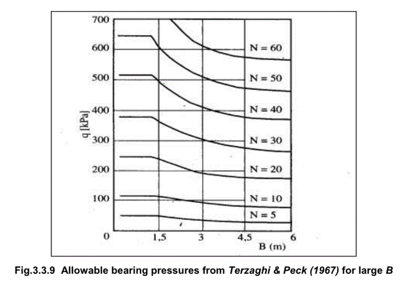

Looks reasonably traditional. See image below.
I wouldn't get too hung up on the number of significant digits. The geotechnical engineer has done a calculation and reported the results. The variance in any row is less than 20% so a rounded number would give practically the same result. This way you get a little more visibility and insight into the expected soil behaviour rather than be left wondering how much the geotech rounded off and wrote off to 'factor of safety'. There may be good reason to keep the digits anyway as the units are mixed - maybe the project is wantonly converting from metric to imperial and losing accuracy if rounded at each step. A rounded number is only rounded in one set of units: 3000psf is 143.6kPa after all (or 150kPa is 3133psf).

Bearing capacity is determined in two ways, the ultimate bearing capacity (failure) and the serviceable bearing capacity (settlement). Starting from a point load your bearing capacity is determined by failure. As you increase footing size the bearing capacity peaks at the transition between failure and settlement control. Continuing to increase footing size your bearing capacity is now settlement controlled which decreases with size.
This is illustrated in Ralph Pecks Foundation engineering book.
The Canadian foundation engineering manual working stress design developed charts based on SPT N values using this concept. With the exception of flattening the failure side and straight lining the settlement side to a maximum footing size.
