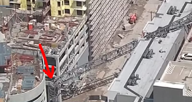

Windstorm - from this snippet - maybe just too much wind drag on the crane and a member failure near the bottom:
faq731-376
Don't say wind until you know it wasn't something else.
The video of the actual collapse was during a severe wind event in Dallas.

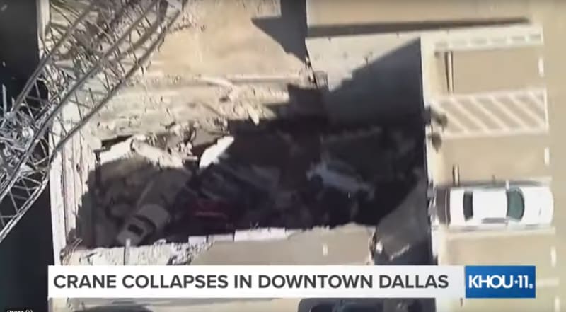

Here's a drone shot of the parking garage portion - looks like a multi-story pancake collapse:

Section fasteners failed due to overload force from wind gust? I hope they don't find fasteners were missing, wrong grade, or counterfeit.
Possibly the correct fasteners were improperly torqued.

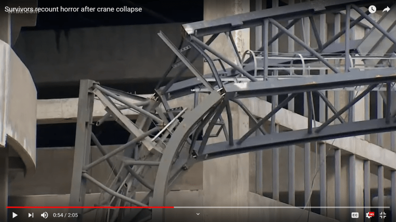

jrs 87- That picture looks strange. It almost looks like a CG graphic, but I assume it's a picture. I think the 'section fasteners' are the long silvery pins exposed between the crane verticals, missing from the members that parted. If so, then I do not understand how they work unless they were left untightened by a foot or so as they span a large gap between the surviving connections. I would expect that they are either through bolts or pins with some type of associated hardware to provide the proper tension. Is there something else going on at this connection? Also, the crane that fell in Seattle a couple of weeks ago looks like these connections were made by cross-bolting together interlocking sections, instead of the surface to surface connections shown here.

Yeah - this tower section construction/connection appears completely different than the Seattle crane. Seattle crane used HSS members at the corners and this one used what appear to be WF. The Seattle crane used some sort of an insert inside the HSS with pins connecting between the insert and the exterior HSS. Pins appeared to be in shear only there.
Here, it seems that the connectors are in tension.

I don't see any distortion of the steel at the left-front leg connection in the video frame posted by @jrs_87. This basically suggests that the bolts/rods never existed. I suppose there is a circumstance where the bolts could rupture in tension as the initial point of failure, but then why can we see the shanks of all the other bolts/rods?
One possibility- the bolts on that one leg failed, the others didn't fail. When the bolts on that leg failed, the leg was still straight enough they could just drop out (more like, got shot out, I guess). The other bolts were twisted around with the structure but didn't fail.
If that was my crane, I'd sure be looking for those broken bolts.
JStpehen, I agree - the initial failure would be pure tension in the bolts; either they parted, lost their heads, or shed the nuts. In any case the leg with the initial failure would be straight. It's all the other ones that would be distorted.

In a tower like this, and almost any structure really, the primary system would have been designed first, indifferent of the connections. The connections would have been designed second, and in some cases by a delegated designer. The main directive of connection design is to ensure that the primary structure reaches capacity, and fails the way the primary system was designed, and not to introduce any new global failure mechanisms. For the bolted connection to fail in pure tension before the other legs failed in buckling would raise flags about the original designs (or material or installation of course).
But if the bolts/rods were properly installed and if they failed in pure tension, then I wonder that I can see no evidence of related distortion in the plate steel around the 4 connections. Just eyeballing it I'm guessing those are 1" bolts with 5/8 plate steel. How do 4 bolts rupture without any flares or dimples or tears in the plate?
