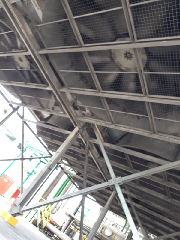

Hello guys,
i have a very strange fact.
i have 7 fan vertical motor-pulley-fan in a steam condensation field and for every motor i collected phase-phase voltage, phase-neutral voltage, and phase current.
All the motor are mechanically and electrically equal and have 380V, 88A, cosfi=0,82 data but during data acquisition i found some with very low cosfi (until 0,6) and very low load (until 53A).
In attachment you found data acquired. I don't know how many time this problem is present.
None have idea about this issue? or can instruct me to find the way to solve it?
PS: There are no problem on belt and the pitch angle for every blade is locked on the main shaft and with correct angle (from constructor)!!

Thank you all for your response.
I want to clarify some things probably not detailed by me before.
[ol 1]
[li]I know about PF concern. No load means more contribute percentually of magnetizing current that is 90 degree by Voltage and PF drops. All this is normal.
[/li]
[/ol]
[ol 2]
[li]This type of fan are made as in a picture attached so every fan suck same air because there is no ducts[/li]
[/ol]
[ol 3]
[li]I made measurements by myself with calibrated Fluke 39 power meter [/li]
[/ol]
[ol 4]
[li] I made today new measurement leaving all the rest in OFF position so all big charge possible for that fan but change a little bit in current (now 57,6) and in the angle (now 51°)[/li]
[/ol]
Why only one motor in same conditions is so little loaded? This is a real little load or could be present a problem in a motor/power-line?

ITSMOKED i'm really sorry.... i forgot [glasses]

Modern optical tacho's that look for the reflections (not the old-style stroboscopic ones) do surprisingly well even in sunlight, especially if you can mark the equipment (pen, paint, ideally reflective tape). From your photo I would say it is well worth a try if you haven't already. Otherwise...can someone on night shift take the readings? .

A chart like this for "my" motor" would interest me if I were concerned about the load on an induction motor.
Maybe the belts are properly tensioned, but if the pulley/sheaves were not the correct sizes then true motor and fan rpm would make it abundantly clear real quick.
Pulley ratio is the ratio of the pitch diameters of the pulleys. While the geometry of the pulleys are fairly accurate, the true pitch diameter depends on how the belts fit in the V-groove. As belts wear they will fit deeper into the V-groove. The percent change in pitch diameter will be greater for smaller pulleys and thus the ratio changes. Fan power is proportional to the cube of the rpm so small rpm differences will result in large power differences.
One other factor I've learned to pay attention to with fan arrangements like this is that all the fan motors are turning in the right direction. It is very common for maintenance people to reconnect 3-phase motor wires motors so the motor reverses. It is surprisingly difficult to observe this when it happens when multiple fans are involved, without feeling the actual air flow.
Sofistioelevib,
Tmoose has it, different pulley ratio (or different belt or different pitch despite locking at construction or reverse rotation) will all show up in slight differences in speed. This lets us distinguish electrical from mechanical factors.

What's on the other side of those fans? Maybe a plugged heat exchanger is reducing the airflow on the spurious motor? Different fan blade, maybe a replacement?

Right now i've no chance to evaluate pitch angle but could be an idea, but effectively this heat exchanger is more plugged respect other
