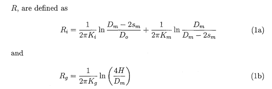

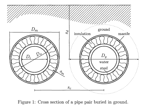

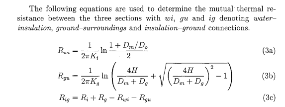

INTRO: In this reference, the mutual thermal resistances between layers as water-insulation, ground-surrounding, and insulation-ground are defined for a buried pre-insulated pipe, figure and formulations given below.
QUESTION: I want to improve the model given in this reference by studying the layers as water, steel, insulation, and ground so I need to obtain the mutual thermal resistances between water-steel, steel-insulation, insulation-ground, and ground-surrounding. I couldn't find a reference describing how to find the thermal resistances between layers of a cylinder (e.g. thermal resistance between pipe wall and insulation and others). Can any of you help me either by giving formulations or by guiding me to a reference?
FIGURE:
FORMULATIONS:

There is typically considered to be none, for two reasons
> they are usually in intimate contact, so the interface layer is extremely thin
> the area of non-contact is usually small
In general, thermal inertia is dominated by the thermal mass of the object and the bulk thermal resistance.
Furthermore, the particular example you selected, water and pipe, are dominated by convection on the water side, and the bulk conductance of water comes indirectly into the calculation.

You are reading the words, but misinterpreting them and the equations. Look at the equations 1a, 1b, 3a, and 3b; they reference the annulus diameters, so all the terms are describing bulk thermal resistances.
