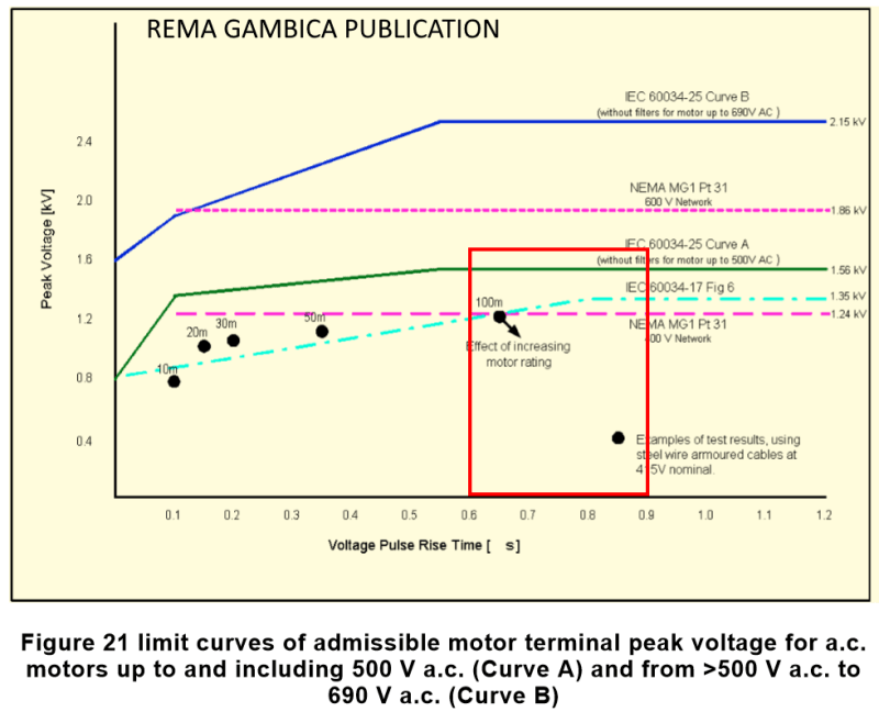

A few curves from the British association of drive and motor manufacturers. Al major makes are represented. And a few less known.
The peak voltage increases with cable length, as Bill said. But when cables get longer than around 100 m, the dispersion reduces that influence.
But it is obvious that a motor that isn't designed for PWM and that doesn't have a filter, will suffer from Ozone (caused by partial discharge in narrow air gaps) between magnet wires and sometimes wall insulation. Ozone deteriorates the insulation. Not good.
