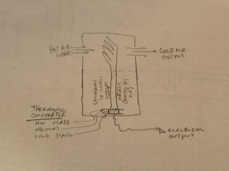

Sorry to invade the forum (I'm not an HVAC engineer, but a utility engineer)...... But I had a thought the other day and it's been on my mind, so I thought I'd ask.
Since there are ways to convert heat to electricity without steam, such as a thermionic converter, couldn't one create a sort of "space cooler" that doesn't need to vent heat to the outside, because it's converting that heat to electricity and using it to help power the other devices in your home?
If not, why? If so, why isn't it more popular?

attempted a basic diagram of a simple version of this.....
. .I just feel like I must be missing something,
The device does not create a thermal gradient.
It depends on an already existing gradient.
Care to elaborate? If not I understand... it's not your job to be my teacher. Especially since I don't plan to build this and it's mostly a thought experiment.
If thermionic converters are used to harvest waste heat in other scenarios, why can't it be used in an AC system? What's the difference between this, and, say, using them to harvest waste heat from a car engine or a computer, which is already being done?
Can you think of a way to change this diagram so it doesn't "depend on an already existing thermal gradient" as you say?

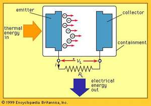

According to Britannica:
[URL unfurl="true" said:
https://www.britannica.com/technology/thermionic-power-converter[/URL]]They can provide efficiency in the range of 12 to 15 percent at temperatures of 900 to 1,500 K (about 600 to 1,200 °C, or 1,200 to 2,200 °F). Since these converters function best at high temperatures, they may eventually be developed for use as topping devices in conventional fossil fuel power plants.
At those temperatures, rejecting from the heat sink to atmosphere should be no problem, the household AC might be running a little hard though. [wink]

My point is that you need to have a temperature DIFFERENCE, somewhere across the device, otherwise, there is no work that can be done by the device, regardless of its efficiency. That means that ANY device that uses heat, must have a cold side to provide the temperature difference, and to sink the 60% of the heat that it collects and doesn't convert to electricity

the "hot plate" of the thermionic converter would feel cold to the touch, ideally, as it is removing the heat from your finger.... just like a heat sync. as it doesn't operate at room temperature this is irrelevant, but i would think it should work if it did
Also if it removed the other 60% of heat, the air coming out would be zero kelvin which is physically impossible.... right?
No, you are randomly correlating concepts. If something is 40% efficient, it means that 60% of the energy it "consumes" must show up somewhere in the universe as waste heat, which requires a heat sink of some sort. The "coldness" that your finger feels is a transient event, like charging up a capacitor, your finger's heat is going into warming up the heat capacity, which can only be maintained until the device's temperature matches that of the heat source.
