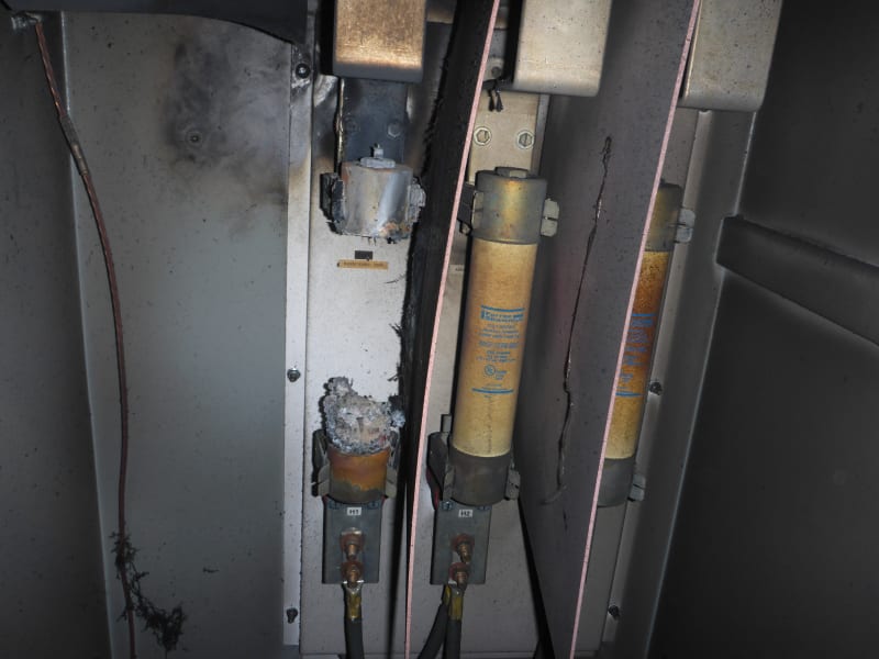

Lots of medium voltage fuses have a minimum opening current which means they will clear properly at higher short circuit currents but may not safely clear low level overload currents. So, this can mean using what seems to be a fairly oversized fuse which relies on a relay elsewhere to catch the low level overloads. Overloading certain medium voltage fuses a bit often doesn't end well for the fuse.
