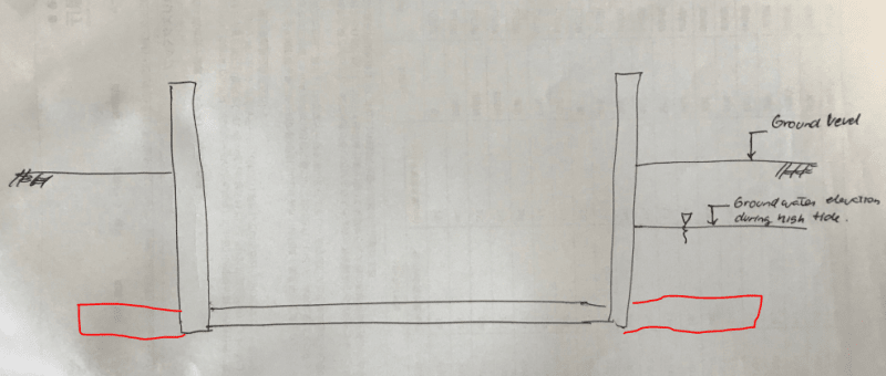

I am confused. I was thinking that since the groundwater is related to the ocean tides, and since the highest tide elevation is higher than the finish floor elevation, during this highest tide, the groundwater will try to push up the slab creating uplift forces. By the way, the slab is enclosed by surrounding walls. I am attaching a crude sketch for reference.

Okiryu - I was assuming the slab was at ground elevation. Since the sketch shows the slab is underground and the space above the slab is "air" there will be uplift. Value of uplift can be calculated using Archimedes Principle - Dry weight of everything in the enclosed space, including the concrete slab, versus the weight of displaced water.

SRE, yes, sorry for the lack of explanation. That's why, I am using the below equation to check the thickness of the slab to resist the uplift force (Assuming that the resistant force is only the weight of the slab.
ɣwater*(H+0.30)=(ɣconcete - ɣwater)* H
0.30 m is the difference between the bottom of the slab and the highest groundwater elevation. And H is the slab thickness. I am getting high values of H so I was thinking if there are other ways to resist that uplift force.

[ul]
[li]check your unit weight and use heaviest aggregate you can get[/li]
[li]thicker slab is the most straight forward way[/li]
[li]you may be able to rely on friction / cohesion along the sides[/li]
[li]a footing can increase the downward load[/li]
[li]anchors might be used as a last resort[/li]
[/ul]

Based on my experience constructing underground hydraulic plugs , I would be a lot more concerned about the constructability of this design, rather than long term uplift issues. Assuming the local tides change every 12 hours or so , and given your financial concerns related to only 0.75 metres, how will the slab resist infiltration and hydraulic forces , when the concrete is only say 6-8 hours old ...... compressive strength maybe 250 psi???
Okiryu - My calcs indicate there is a problem with the formula you are using. I get a thickness 0.133 meters... of course a flotation safety factor is needed, so thickness would increased.
Where I am (coastal South Carolina) height of tides varies daily, roughly correlated with motion of the moon. Also, storm surge (from hurricanes or other wind events) can cause water to be much deeper (say 5+ meters deeper) than a even an extreme predicted high tide (a so-called King Tide). BTW, for these reasons true basements are very rare here.
The project you are considering is really a small scale cofferdam, the floor being the concrete seal, with exactly the same problems and solutions needed.

Buoyant force = length x width x height x 9.81 kn/m3
Height is gw elevation minus bottom of slab elevation
Concrete floor force = length x width x thickness x 24 kn/m 3
If you want to consider wall weight add wall thickness x perimeter x height of wall x 24kn/m3
I use 24kn/m3 for reinforced concrete. You can add dead weight of house on that if you want. Also building below the groundwater table means waterproofing. In my jurisdiction that means two floor slabs separated by bitumen.
Hi SRE...I made a mistake in my explanation - the 0.30 m difference is from the top of the slab but I can see that you are considering the weight of the slab as the "actual" weight (2310 kg/m3). I was considering the submerged weight of the slab (2310 kg/m3 - 1025 kg/m3 = 1285 kg/m3).

Okiryu - Consider an arbitrary 1 meter square area of floor:
Weight of concrete floor = 2310 kg/m3 x H
Weight of water displaced by concrete floor plus the "air" above it = 1025kg/m3 (0.30 + H)
These two quantities have to be equal for the "cofferdam" not to float:
2310 (H) = 1025 (0.30 + H)
Solve for H. I get H = 0.24 meters (floor thickness)
I agree that weight of perimeter walls (and interior walls, if any) can be considered toward overcoming buoyancy... however this can create a new problem. All of the wall weight is applied at the perimeter (or at the location of interior walls), not uniformly across the floor. If the floor is not make thick enough to resist buoyancy with the floor's own weight, this "thin" floor will have to be designed as an up-side-down structural slab to resist the uniformly applied hydrostatic uplift underneath the floor.
