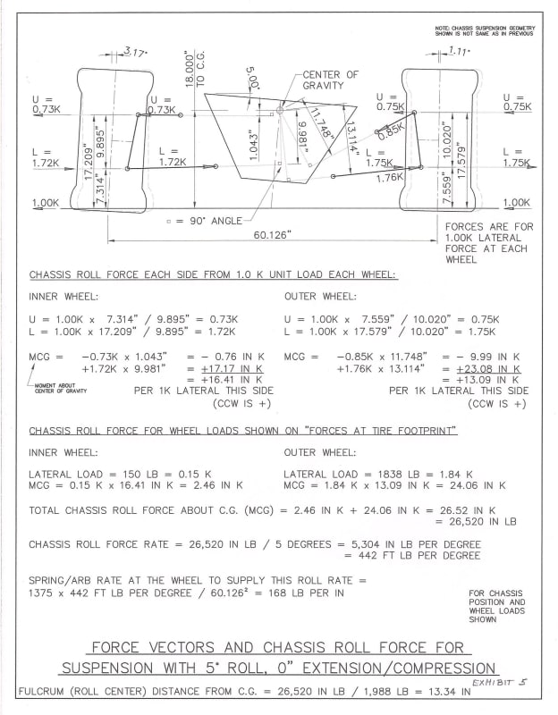

I was talking with my rat rod builder neighbor about the fallacy in the definition of “Roll Center”, and I showed him a procedure for calculating roll forces (see sketch attached). He looked at it for a couple of minutes then said, “Oh, the suspension linkage on each side is just a compound torque wrench on a big nut located at the center of gravity”. I like his description so I sketched it up as well (also attached).
Any comments?
 https://files.engineering.com/getfile.aspx?folder=6c549675-1775-4ad3-964e-835f27bf6b73&file=Exhibit_5.jpg

What exactly is the 'fallacy' you're dispelling here?
There is an old wive's tale that the car rolls around the roll axis defined by the roll centres. Unfortunately it is recorded for posterity in Carroll Smith's otherwise excellent books.

Here’s the sketch of the compound torque wrench that models the suspension linkage. I made a model in my shop - this is a good tool to feel how lateral tire forces acting through the suspension linkage can affect chassis roll torque.
But is still is not a "roll center".
 https://files.engineering.com/getfile.aspx?folder=5c0bf575-b984-4746-b220-1ef078c0b620&file=Wrench_Equiv.jpg
So, I'm checking the Adams Tutorial for their methods of computing suspension geometry related chassis roll, and they have a bit on computing the "roll center". I stopped there.
