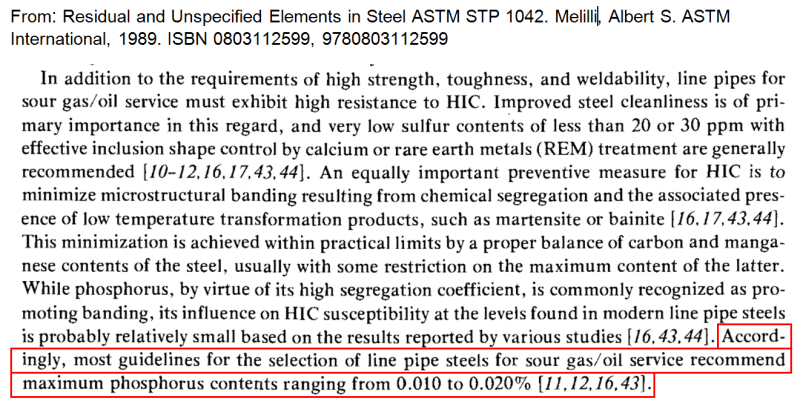

Does anyone know if there are other NACE or EFC standards that list a Phosphorous limit? Where did the information/research to limit Phosphorous come from?

The restriction is due P element is an easy to segregation element, so the increase of phosphorus mass fraction will lead to the increase of banded structure, thus increasing the sensitivity of the steel HIC.
That restriction came from multiple studies that stablished guidelines for the selection of line pipe steels for sour gas/oil service.
