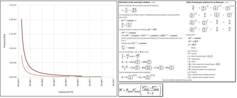

A p-v diagram would be nice.
How are you calculating thermal efficiency?
2:1 expansion ratio with 60% TE???
je suis charlie
The estimates are from my course thermodynamic model. Performance is estimated by calculating isentropic relations for start/end volume, pressure, and temperature for each of the major cycles that produce or consume significant work (pump compression, charge compression, combustion/expansion) at sea level. Gamma (y, ratio of specific heats) is calculated for each step based on temperature. Work (W) is then calculated for each step then summed and IMEP calculated. FMEP is the average of Heywood and Ricardo figures for typical engines. BMEP is then calculated and used to calculate HP, Torque, efficiency, and BSFC. Next, I reduce efficiency by 8.7% to reflect typical heat loss in an opposed piston engine then recalculate performance at the lower efficiency. I don't bother calculating air pump intake or the scavenge cycle because both are low pressure processes using low tension rings and should have little impact on total work (assuming properly sized ports).
I'm now updating the more detailed model that uses actual cam timing and Hohenberg's heat transfer coefficient to calculate heat loss for each one-half degree of the cycle. This model is a lot more work because it incorporates a host of detailed characteristics (port area, cam timing, reciprocating mass, cam loads, etc.), so I never undertake it until the preliminary model looks good (meaning it shows excess performance relative to goals).
I misspoke regarding expansion ratio (the ratio of P3|P4 volume at exhaust vs volume at intake). Though I *set* it at 2:1, the preliminary model limits expansion to ensure minimum conditions when the exhaust port first opens (the lesser of 4 bar pressure or 850F temperature). As it stands, the compression ratio of the air pump (P1|P2) is 1.44:1 while the main cylinder (P3|P4) has a compression ratio of 18:1 and an expansion volume equal to 1.16x the intake volume before compression starts.
So an expansion ratio of 18 x 1.16 = 20.88:1?
That makes a bit more sense.

gruntguru, It seems I've abused terms again. Yes, the ratio of volumes from combustion to opening of the exhaust valve is 20.88:1.

If a conventional diesel engine had an expansion ratio of 20.88:1 (to the point when the exhaust valve opened) it would mean that the geometrical compression/expansion ratio would be about (at a guess) 40:1. You get the same effect with a conventional petrol/ICE engine - if the CR is 9:1 and the temps of combustion and exhaust are typically about 1900/700 degrees C - this equates to about an actual effective 4:1 expansion ratio. Sorry about the guesses but I have worked it out more accurately before and I recall that the figures are something like these.

BigClive,
I may have changed my target exhaust temp since I wrote the post, but I don't think I've changed it much. Here are the key parameters...
Air Pump
Start Volume: 2.76E-05 m3
Start Pressure: 101,493 Pa
Start Temp: 288K
Air Mass: 3.39E-05 kg (note some will be lost in manifold during transfer to compression cylinder)
y: 1.380 (gamma, ratio of specific heats)
End Volume: 2.25E-05 m3
End Pressure: 134,175 Pa
End Temp: 311K
Compression
Start Volume: 1.01E-05 m3
Start Pressure: 134,175 Pa
Start Temp: 311K
Air Mass: 1.52E-05 kg (mass in 12.375 cc volume at sea level pressure and temp)
y: 1.332 (gamma, ratio of specific heats)
End Volume: 4.88E-07 m3
End Pressure: 7,613,756 Pa
End Temp: 852K
Combustion and Expansion
Start Volume: 4.88E-7 m3
Start Pressure: 21,000,000 Pa (210 bar, a design max)
Start Temp: 2,000K (peak combust temp, a design max)
Air mass: 1.52E-05 kg
y: 1.280 (gamma, ratio of specific heats)
End Volume: 1.35E-05 m3
End Pressure: 298,979 Pa
End Temp: 788K (chosen to ensure catalytic converter operation and at least 2 bar delta to ambient pressure).
Cylinder Performance
Work: 11.35 J per each of four cylinders (includes expected 17.4% heat loss)
IMEP: 9.17 bar per each of four cylinders
FMEP: 0.53 bar per each of four cylinders (average of Heywood and Ricardo)
BMEP: 8.65 bar
Engine Performance
Displacement: 49.5 cc in all (four) cylinders combined (12.375 cc each)
HP: 10.1 all cylinders combined
Torque: 20.1 lb-ft all cylinders combined
Equivalency: 0.403 (36.4:1 air to fuel ratio)
Efficiency: 60%
BSFC: 0.230 lb/hr/HP
Fuel Characteristics
Type: Diesel #2
LHV: 42.8 MJ/kg
Stoichiometric AFR: 14.5:1
Ignition Delay at 311K: 5.2 ms
Ignition Delay at 852K: 1.0 ms​
From the above, the Air Pump compression ratio is 1.22:1 and the Cylinder compression ratio is 20.72 yielding a combined 27.7:1 compression ratio while the expansion ratio is 27.7:1. I'm not sure if, when discussing expansion ratio, it should be compared to Air Pump * Cylinder compression ratio or just Cylinder compression ratio. It's really only a matter of terms, however, and the safest way is to provide all three figures as I have. Regardless of wording, the result is calculated as the air moves through the engine stages and I'm reasonably confident my calculations are correct. It's very important in reviewing these figures to note the engine uses HCCI combustion, the closest approximation to constant volume combustion, which does not spray fuel during the expansion stroke.
Rod
P.S. The illustration I posted at the top of this thread was intended to be a simplified representation of how the engine works. I presented it as though the cylinders were stationary while cams turned to move pistons to avoid the confusion I usually encounter when trying to explain operation when cylinders are rotating and cams are stationary as they are in the *actual* design (a Rotating-Cylinder Radial Two-Stroke Opposed-Piston Miller-Cycle HCCI Engine [smile] ).
Expansion ratio describes the mechanical behavior during the portion of the cycle during which power is extracted.
Unless the 'air pump piston' is generating power, the expansion ratio is just the reciprocal of the compression ratio of the actual working swept volume, ie 20.7.
jgKRI,
In that case, I am "over expanded" meaning the ratio of (volume at exhaust port opening)/(volume at ignition) which is 27.7:1 is greater than the compression ratio of the primary cylinder alone which is 20.7:1. This difference is the result of my using a "Miller Cycle" in the main working cylinder... I hold the intake port open while the piston moves up a bit from the exhaust port so the compression stroke is shorter than the expansion stroke.
Rod
I feel like we've been down this road before (arguing about the fine details of terminology) and at this point I have a great deal of respect for the work you're trying to do, but man... this is why people get confused when you try to explain your concept to them.
In your diagram above, the P3/P4 pair are exposed to combustion pressure, while P1/P2/P5 are used only for managing airflow, and are never exposed to combustion pressure- correct? When you say 'air pump piston', which piston are you referring to?
If that is the case, the expansion ratio is the ratio between maxima and minima of that swept volume.
For your engine it's more complicated than for a simpler conventional piston-rod-crank architecture, sure- but the expansion ratio, as a property, does not care about the physical linkage used to control the change in volume. You have the added wrinkle of making it possible to have compression and expansion ratios which are, in fact, different. But expansion ratio still represents only the ratio of the two instantaneous states.
Is the ratio of maximum to minimum volume of the P3/P4 area 27.7? If so, I agree then that's what you should call 'expansion ratio'.
JgKRI,
P1/P2 are the “Intake Air Pump,” P3/P4 are the “Compression/Expansion” pistons, and P5 is the “Scavenge Air Pump.” The P3/P4 pistons have a 20.7:1 compression ratio and a 27.7:1 expansion ratio.
I know I stumble over terminology. It’s caused by the fact that I don’t speak to experienced engine designers anywhere but here (and occasionally with a consultant) and the engine is inherently confusing because it’s so different. The math is unambiguous, and I’ll eventually get the descriptive terms right.
The thermodynamics don’t care how I effect compression, and that’s why I got confused as to whether the Intake Air Pump compression ratio should be included in overall compression ratio.
