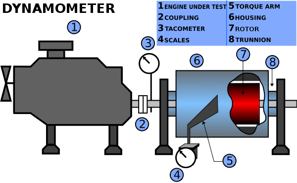

What drives this thing? Can you measure the torque there? I'm thinking of the neighborhood "mechanics" that would calibrate their flexible motor mounts with a torque wrench, then read the torque output by the corresponding movement of a bar bolted across the top of the engine while racing up a hill with the hood off.
Can you mount the motor like a dynamometer?

Brain many thanks for both of your responses. I'll definitely have a look slip ring assembly to see if there's anything suitable. The dynamometer idea is quite interesting but I'm not certain if I can pull it off because the shaft has to be vertical.

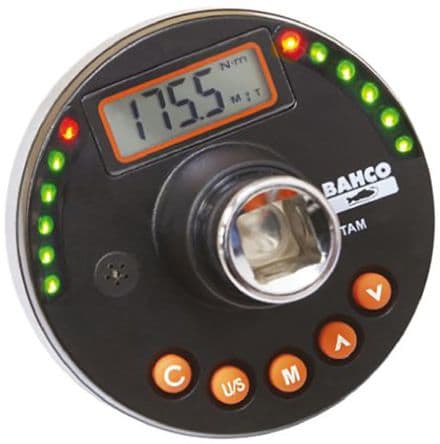

Buggar, It's a small rotating mechanism, the purpose of the shaft is to make it easier to estimate the mechanical power coming from the mechanism. With regards to the torque wrench do you recon there's anyway it could be used to estimate the torque of the shaft in some way? I've attached an example product to shown what I mean. Thanks again for your interest in this problem.
Similar to what Brian mentioned, would a Prony brake work?
Kyle
Whether the shaft is vertical or horizontal does not mater to a dynamometer. It measures reaction to system torque not reaction to weight (gravity).
