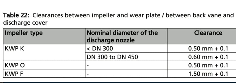

Hi everyone
We have a flowserve pump , type kwp-ox with slary fluid that clearance between impeller wear ring and casing wear ring is 0.5mm in ducument . and problem is when we set clearance 0.5 mm fine powder to be formed in our process . so what we can do ?
RE: Flowserve kwp clearance ???
If pumping fine slurry, you might need a rubber lined pump.
