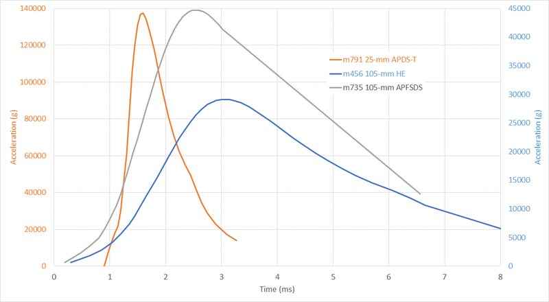

To clarify and expand on this, the acceleration experienced by an artillery shell is on the order of 15,000g.
It's obviously pretty much like 'being shot out of a gun...'
The single task is to hit the target.
But this 'single task' includes battery and power supply, sophisticated GPS system including antenna, inertial measurement unit, even laser seekers in recent versions, computer guidance of course, fin actuators, and much more.
(All this is public info.)
Joke Alert: Dealing with the 15,000g requirement is trivial. One merely opens up the Requirements database and types it in. Easy! ;-)

Kinetic impact - even of a solid object far larger than the old battleship projectiles of 2000 - 4000 kg at 1500 kps would likely be too little energy.
I've run the interior ballistics analyses for a couple of cases in the dim past. The numbers can actually be much higher, particularly for tank rounds. Thankfully, the duration is short.

IRstuff,
I've fired those 105mm rounds. I used to be an M60 tanker. At least the HE (training) rounds. What's APFSDS? Is that Sabot rounds?

Yep, Armor Piercing, Fin-Stabilized, Discarding Sabot.
