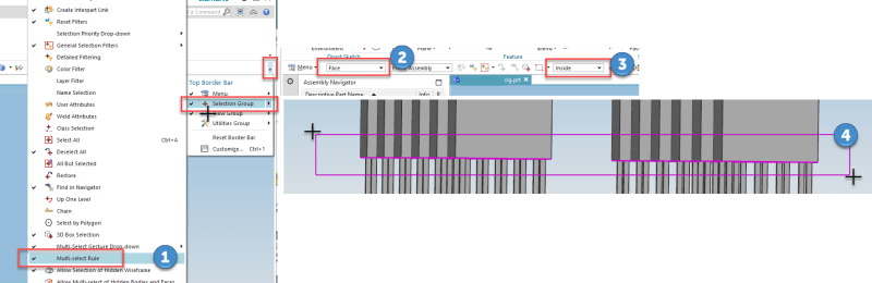

Hi pros,
I'm running UG nx 11,
I got into trouble with select thousands of similar faces (as attached file)
i also tried to use Filter by radius but it didn't work in this situation.[ponder]
- I found that Ansys workbech CAE software allows me to select desired faces by "square".
but in UG/NX which button should I use?
Does anyone can help me ?
thank you !

1) turn on multi select rule, then set the selection filter to faces and make sure that the rule is "inside",
rotate the model such that you see it from the side, ( See the attached image)
Does this help ?

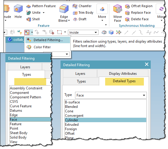

If this is native NX geometry, the red faces ( which i assume that you intend to select) would probably be "cylindrical". ( defined by a cylindrical equation)
( select one of these and press Ctrl+I and the listing window will report the type of geometry)
- You can then limit the selection to cylindrical faces only as seen in the image below.
So in combination with the previous... Does this help ? :-)

Hi Tomas
that's exactly what I'm talking about !
