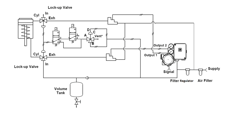

I am working on a pneumatic loop for An anti-surge valve. i used a quick exhaust valve to seep up the exhausting. but An senior engineer told me that Quick exhaust valves would be not recommended for Anti-Surge valve and they would be forbidden to be used. And the reason is that the quick exhaust valves are not reliable and stable because of the exhausting action is so fast. it is common application rule?
Actually, I didn’t agree with that. because Finsher's typical application that the quick exhaust valves should be used to speed up the exhausting.
Could you please give me some advices about that?

Are you asking about the exhaust from a double acting pneumatic actuator, and exhaust from side keeping the main valve closed (or open?). What is the media on the other side, air or spring, Do you want the main valve to react as fast as possible or damped, and what is the required time for total movement (one stroke)?
Apart from above, that may influence quality of the response you get, I tend to agree with you. But please be reminded that the total actuating result is depending on all dimensions of piping, air valves and actuator cylinders and internal borings. A quick exhaust valve of good construction might be one of several possible construction and valve selection solutions.

Yes, You are right, it is a double acting pneumatic actuator. The image is the schematic of original design. img https://res.cloudinary.com/engineering-com/image/u...]
and the valve shall act as below:
1. Closed Loop Control Zone (Positioner, Solenoid energized ),close time<10S;
2. Open Loop Control Zone (Solenoid De-energized), open time<1.56S
we did connected all the accessories per the original schematic but the valve could not be quick opened <1.56S. So I changed the loop and added an lookup valve to speed up the exhausting. and reconnected the control loop and the result is ok, Open time <1s.
the modified schematic drawing as attachment.
But unfortunately, my boss said it is wrong to use lockup valve to speed the exhausting. And any quick exhaust valves or equipment shall be forbidden to used. I have no experience about this. So I want to discuss here.

I agree with you. If I read the diagram correct I can not see anything disturbing or making the open or closing acting more unsure in itself, the extra valves give extra boost by parallell action.
One can of course argue that more components increases the risk, and component numbers should be kept at a minimum. This will require larger dimensions for some components.
RE: Quick exhaust is not recommended for Anti-Surge Valves
What is a lock-up valve as compared to a quick exhaust? From the way the valves are plumbed in the drawing they do not appear to be what I would call a quick exhaust valve. A quick-exhaust valve only has inlet, cylinder and exhaust connections.

I have gotten the answer of my question. The answer is the quick exhaust valves can be used to Anti-surge valve. As for why the quick exhaust valves are forbidden, the reason is very funny.
The root cause is that our assemblers very often connected the quick exhaust valves with wrong way, and the complaints from the customer is so many that application engineers decided the quick exhaust valves were forbidden.
