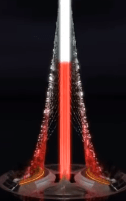

Possibly the most impressive structure on the planet! If you haven’t seen the dubai creek tower online check out google images. Its currently under construction.
Over 1Km high, its essentially a large compression tower stayed by cables.
No doubt these guys have it all figured out but i’m not fully convinced on how such long cables react to vortex shedding, extreme dubai heat or earthquake.
We have a famous Calatrava bridge here which had to be hosed down to tighten the cables after they expanded during a slightly warm day in Dublin. The bridge was open at the time and couldn’t close again since the deck dropped when the cables stretched! How do 1km long cables perform in the desert heat?!

I guess if you can do suspension bridges with nearly 2km clear spans, turning it on the side and saying it can cantilever half this distance isn't entirely out of the question. Given only 3/4 planes of cables they must be working pretty hard as hardly very efficient, bit hard to tell from the many variations of renders exactly what is going on though with the cables, some renders show some pretty crazy cable nets like below (which for certain directions wouldn't seem like they actually do too much). I guess like the height they are keeping the exact form under wraps.

EDIT Heres a video of a 'scale' model of the tower, cable net looks pretty intricate!
I've heard of planes cutting TV antenna guy wires but nothing bigger like these cables must be. I'd suspect you'd have to get really lucky hitting the cable with the prop of the plane; otherwise you'll probably not do much more than scratch the paint. Still, even if it didn't take out anything serious the financial cost of inspecting and replacing a bunch of cables if damaged would likely be extreme.
I just gotta say; I'm honestly more impressed by that model Agent666 posted than the building. The model does a great job of showing the pattern in the cables.
