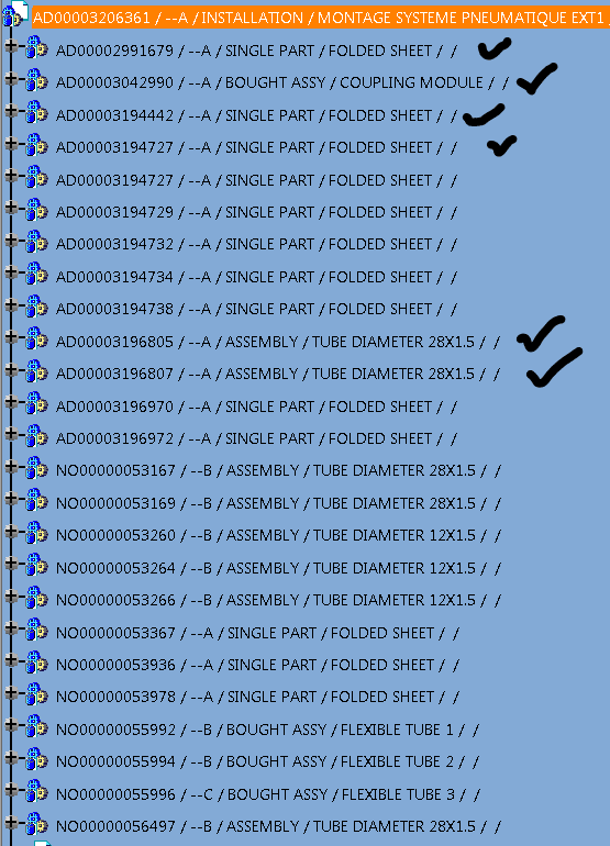

While using the code given in the Macro to rename and save all unique parts in a product an error regarding 'save as' pops up .
can someone post generalized macro to save cat parts , cat products etc in desired formats like 3dxml , stp etc.

my task requires me to just save all the catparts and catproducts in a given installation locally in the specific folder (preferably in STP format).
thanks in advance .
the problem is as shown in the image I need to save all the parts in specific format .Ex- Single parts as individual STP files , and assemblies as individual STP files .
I have to upload cat parts from local folder and get them converted into the required format if I use Utility option . I don't have the catparts (installation 3d models) saved locally . I load them from ENOVIA and have to save each locally in the required STP , 3dxml format .If it can be done by utility option please tell me how .
Thanks in advance

I tried .The main problem is single parts inside the assembly get saved ( instead of assembly as a product itself) , so it creates a problem .If somehow I can save single parts as CATParts and assemblies as CATProducts in one shot it will make work easier.

ans - No , because the above code which I customized seems almost complete . Because I have already written a code to load CATParts , CATProducts from local and save them in STP , 3dxml format . Here in this case as I load the installation (CATProduct) which child products when I try to save locally only single parts get saved ( all the single parts , including the ones in child CTProducts).
So when I try to convert them into stp or 3dxml by importing them from local files only single part SP or 3dxml gets generated and child CATProducts are not saved .This part is bugging me - how to save installation locally as it is ( as the given tree structure ).

If I understood well, you cannot save CATProduct from ENOVIA to local folders. For this, you need to use SendTo Directory.
Another idea is to get names and position of the CATParts/CATProducts from your CATproduct in ENOVIA and rebuild the CATProduct locally using data extracted before.
Another idea is to make an AllCATPart from CATProduct, then break it in a local CATProduct (you can use another macro for this) and replace those new created parts with yours (if is necessary) to have the CATProduct from ENOVIA.
After this, using the right license shouldn't be a problem to convert to what ever you want. But if you convert to stp or 3dxml I suppose you don't even need to do the replacement.
