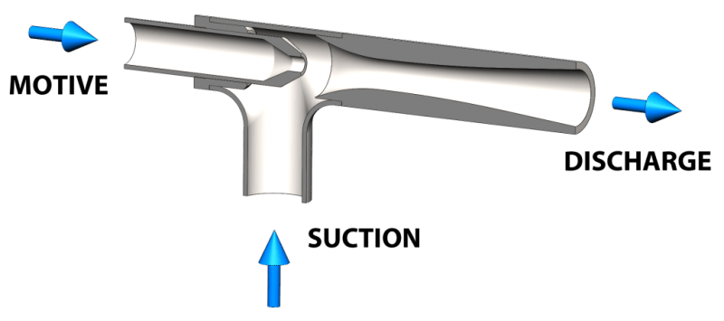

Thanks! 5 - 7 psi for the static mixer was one missing puzle piece, the other was the headloss of the venturi pump. Do you have any idea or guidance here?
When you say a venturi pump, are you talking EDUCTOR? If so, the eductor manufacturer should give you the requirements for this.
This below is based on the assumption that you are using an eductor/venturi for extracting Ozone. See image below. In this image, you know a given required Ozone flow from the SUCTION side. Based on the pressure on the ozone side and required flowrate of O3, the eductor manufacturer will give you the MOTIVE flow and pressure. Add additional static mixer loss, and other dynamic losses in the piping and you size the pump on the MOTIVE flow side.
