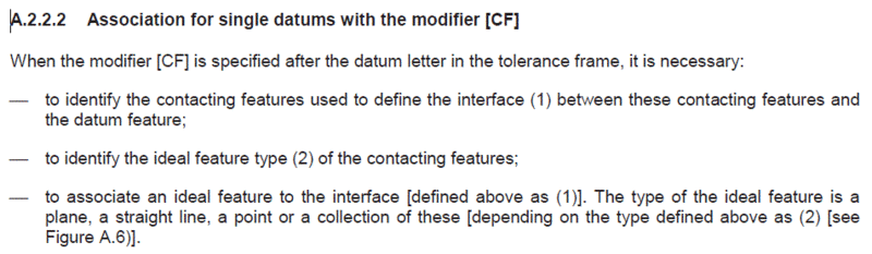

Presence of a modifying symbol CF (Contacting Feature) in the feature control frame implies that some portions of datum feature are used to simulate datum and contacting features should be specified on the drawing.
ISO 5459:
In an example below:
“, the datum A with modifier [CF] is a set of two perpendicular planes and not the axis of a cylinder. The first plane contains the datum target points; the second plane is the median plane of the datum target points, perpendicular to the first one. This median plane contains the set of axes of possible associated cylinders (with variable diameters) from the datum target points. If the modifier [CF] had not been used, the datum A would have been the axis of the associated cylinder.”
If your drawing contains these targets, use them. This would make measuring a lot easier, actually.
Datum feature A is a complex feature and without CF it must be used in its entirety. I’m pretty sure that datum A shouldn't be simulated with 1mm offset. You’d need to simulate it with “true geometric counterpart” – inverse shape which contacts the surface at its actual location (unrelated actual mating envelope)
To answer a question how datum B should be simulated, you need to look at Datum Reference Frames, which contain datum B and associated modifiers (if present).
