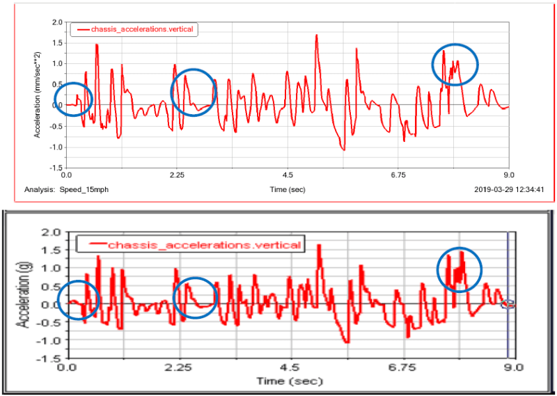

I'm using an MSC model called mini-Baja that has been built in Adams/Car 2005 and anlysing it in Adams 2018 . Mind you , the files are ready on MSC Adams official site .
problem is that I can't get the exact results from Adams/car 2018 Postprocessing …( Minute differences ) the parameters I want are vertical chassis acceleration and chassis longitudinal velocity
no matter what I did from changing units to changing solver integrators ( to the best of my knowledge ) was nigh on futile ...
can you explain how this happens ? is it a matter of changing Solvers Integrators because I have tried almost all of them ? was there something in Msc /Adams car back in 2005 that is changed in 2018 ? if so what can i do to get the exact results ?
my results are very similar to the results of the model in 2005 but with minute differences ? what is the reason of those minute differences ?????
FYI : i'm running the model in File Driven Events and the Baja vehicle model has post-made files for that ...
thank you very much
There are incremental changes in the way that templates are turned into adm files, which is what the solver actually runs. So if you build a model in 2005 and 2108 you will probably find slight differences. The solver also changes between releases. MSC support may be inclined to help you with that.

so i have uploaded an image of my analysis(exact same model and tets File Driven 2018 ) and the result of the model itself in 2005
would you tell me if the diferences are normal ?
as you said the differences often happen so these minute diferences that i have circled with blue would be normal right ?
sorry to consume your time ...
also i detected that with the units being different in each model but resulting the same peaks in the gragh , the original model units might be wrong ( by the owner or builder of the model )
what do I compare your file with ???
The adm from your model. adms are written in solver language, that pretty thing on your screen is no use to the solver. Export has several options for adams files, I think one is called adams solver dataset or something like that, you want a .adm file that looks similar to the one I posted.

With Greg here.
The model you are working with will be translated/exported to the form that the solver can understand. All it takes is for the MSC team to make some change in the the export scheme and you'll get a different result. As your GUI starts working with ever more abstract concepts, the direct mapping from GUI to solver disappears. You might find details in the release notes, if a subsystem's export method has been improved.
