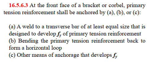

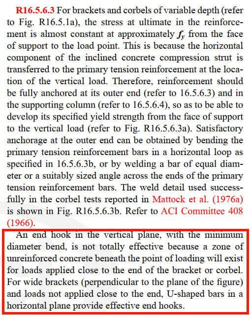

I'm not sure I'm a fan of that detail since ACI 318M-14 16.5.6.3 explicitly requires the bar to be developed by (a) a weld to a transverse bar, (b) the rebar bent in a horizontal loop, or (c) some other means of anchorage that develops fy.
The commentary, in particular, advises against vertical hooks/bends.

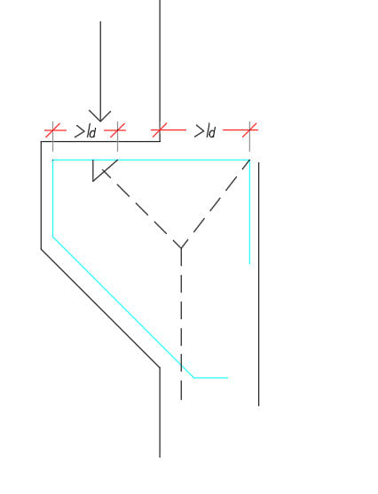

With all due respect, hook development for a #5 (at least based on the ACI equations) is not met (at least, not without going into curved bar nodes and the likes).
If a strut and tie diagram is superimposed on top of the stirrup in the detail you linked(see the very crude sketch below), the hook development length must fit between the edge of the corbel and the end of the nodal zone. Assuming that the reaction is somewhere in the middle of the corbel, there isn't that much space to develop the bar.
My question concerns the fact that, by bending the bar in a horizontal loop or welding it to an anchor bar/bearing plate, the code prescriptively states that that bar anchorage is satisfied, yet I've been unable to find further guidance on the topic. Since my application is not strictly a corbel (dapped beam + beam ledge), I don't want to apply this provision to a different use case blindly. Is there any good document/paper concerning the development length of bars anchored in this fashion? I'm fairly sure I'm probably overthinking it, but I'd rather be certain that I'm not missing anything.
Then again, (and as you state), the detail clearly works since it has been used repetitively. My guess it that the bar bend at the ends acts as a curved bar node, but I defer to anyone more experienced in the subject.
If the stirrup was the only reinforcing, I might agree with you about it not being developed (I'd have to check my AASHTO spec, but I think 8" is at least close the the full hook development length for a #5, 60ksi bar). However, there are 3 horizontal ties around each stirrup and horizontal and vertical reinforcing layers in the rear face of the abutment, that the stirrup and ties extend beyond. While that is not explicitly accounted for in the calculated hook development length, in reality, it has to make a difference. We haven't gotten into designing by the strut and tie method much yet, but I believe the the 3 horizontal ties change the modeling, don't they?
