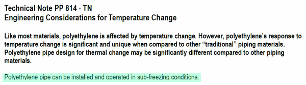

Hi All,
I am looking for the thermal expansion coefficient of HDPE (PE 100) at -2.2°F, to calculate thermal expansión for HDPE Pipeline (PE100).
I still can't find a document where to get this data and to calculations back up.
From DriscoPlex Technical Note PP 814-TN, Engineering Considerations:
DriscoPlex brand includes PE100:
Normal use includes subfreezing temperatures:
Thermal Expansion:

For typical engineering purposes at the temperature of interest, not for polyethylene and certain other plastics used for piping. One value for thermal coefficient of expansion is considered adequate for the range of temperatures (including below zero) where HDPE is an appropriate material.
The complete answer is in "Thermal Expansion and Contraction in Plastics Piping Systems", PPI TR-21/2001 published by the Plastic Pipe Institute.
Interesting that in a later follow-on question in different forum, the OP disclosed that the pipe is to be buried... making the effective coefficient of thermal expansion more like 0.0 x 10-5 in/in/oF (i.e. zero), because of restraint by soil friction.

Since a temperature change of 1o Kelvin = a temperature change of 1.8o Fahrenheit, and if my math is right, 140 ppm/K = 7.78 x 10-5 in/in/oF
7.78 x 10-5 in/in/oF is pretty good agreement with the published DriscoPlex value of 8.0 x 10-5 in/in/oF (see excerpt from DriscoPlex literature shown above).
