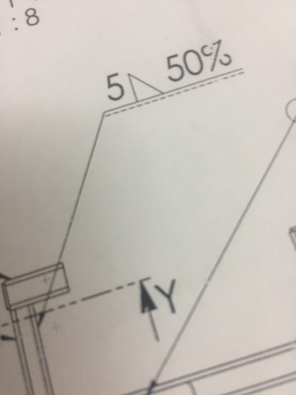

Secondly I have clarification on welding symbols
Please help me how to study the following welding symbol on drawing

It is interesting that the welding symbol is ISO, but it doesn't follow the full format of ISO. You should get clarification with regards to the welding requirements. ISO allows one to specify the weld size based on the throat dimension or the leg dimension. The length specified is not in accordance with ISO as well. Get clarification.

2) Regarding welding symbol 50% meens what can any body help the symbol meens
