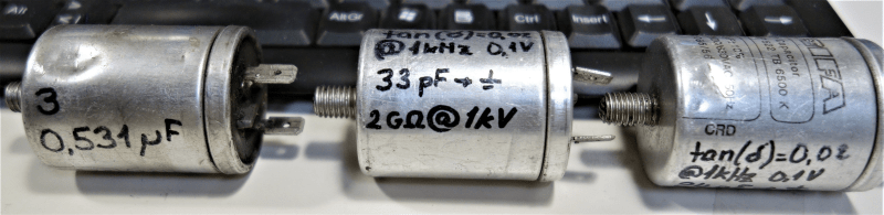

Just checking an ASEA MF induction furnace H bridge inverter. There were capacitors that looked like this:
They all have dents in them. Obviously from the use of a polygrip instead of a prober (band) tool. They are quite old but checked out good. Meggered with 1 kV, measured capacitance, ESR, insulation to can etcetera. They all checked out good.
But it is not good, of course, to dent them. You never know what happens after a while.
They have been running for around forty years. No maintenance. Ever. It is about time, I think.
