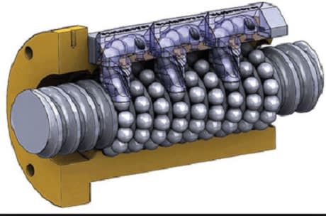

Hello eng-tips,
ISO 3408-5 Standard gives these parameters :
Number of loaded turns
Number of unloaded balls in the recirculation system
want to check that I am understanding these correctly.
See attached photo
Circuit : 1
Number of loaded turns : 9
Number of unloaded balls in the recirculation system : approx 18
