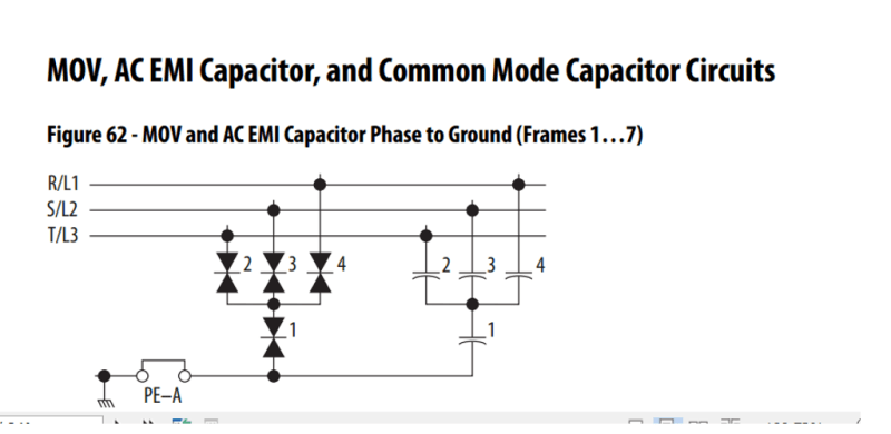

I think waross hit it on nail head.
There is probably that link where needs to be disconnect for a delta config on the VFD.
Its usually some MOV to ground that is usually a screw bolt that needs taken out on install.
This happened to me in past was a painful memory.
This is just an example not sure what your documentation looks like for your drive

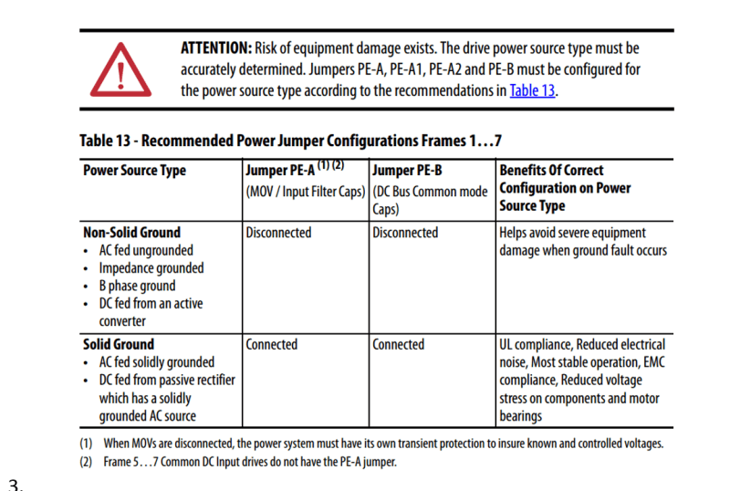

controlsdude; Thanks for the picture. Makes sense. However this drive has no neutral connection to it. It does say on page 16
ATTENTION!
The power supply that feeds the inverter must have a grounded neutral. In case
of IT networks, follow the instructions described in Item 3.2.3.3 IT Networks
on page 17
Which it does since the panel is supplying single phase loads around the facility. There is no neutral connection to the drive. I took their point to mean they didn't want unconstrained earth potentials available and having the panel neutral does this.

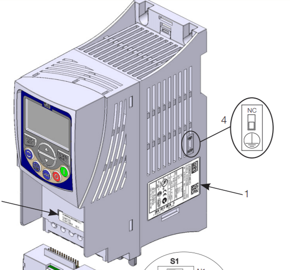

Nope! Not it.
I just looked at the carcass and there is no internal filter and the switch opening has nothing behind it. No switch installed.
