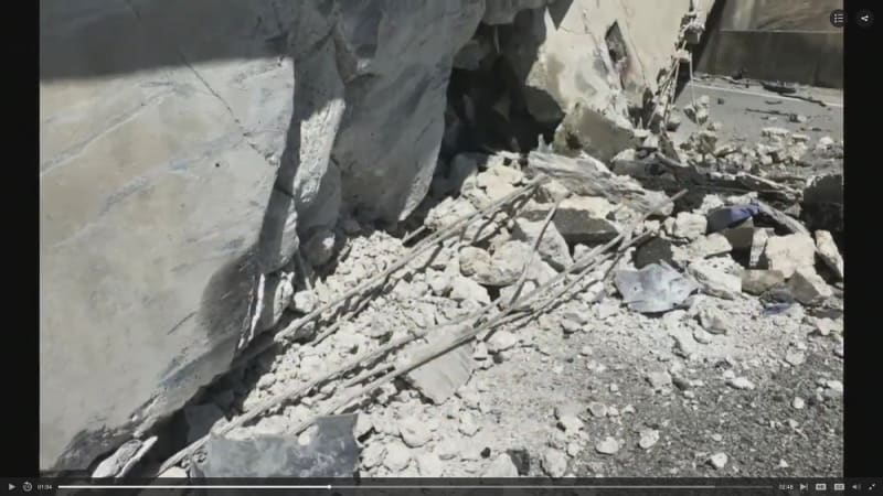

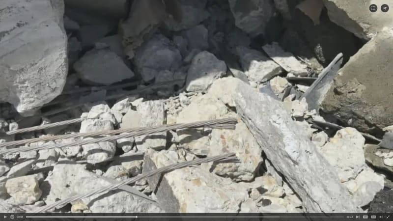

The theory is that an oversized load impacted the overpass at some undetermined time prior to the collapse. The evidence supporting this is that five of the tension cables along the base of the beam are cleanly cut in a straight line.
Here are some screen captures of the cut cables.
It is common for precast/prestress spans to be damaged by over-height vehicles and then repaired many times over, maybe too many times. When the strands are broken or badly damaged they will be cut out and replaced with a section of cable using couplers. Sometimes the span will be preloaded during the repair.
In the street view shots it looks like the span may have been previously repaired based on the irregular concrete lines. From the incident shots it looks like the tendons are cleanly cut which speaks of a repair, perhaps improperly executed. The failure near mid-span (directly above the left lane) also suggests a pre-existing weakness in the tendons at that point. The bridge file of record should show the repair history.

Something going under struck it and they believe it cut 5 out of 24ish strands based on chief engineer at dot in the video at Spartans link.
Looking at the 2018 inspection report page 20 of 33 they call out an area with rebar and strands being exposed. Would this area line up with this or is that a different span? I can’t tell how to figure which beam is which.
Reading charliealphabravo‘s post got me wondering if a truck hitting the beam would cut the strand cleanly like they show in the picture. If the strand they used in the 50’s is like what we have now I would expect it to bend before breaking. Prestressing plants regularly harp the strands a considerable amount with no problems. Plus to cut the strand the impact would have to cut through the concrete. I would imagine the concrete would take the brunt of the impact.
The engineer in the video seemed to think impacts like this were quite common and had happened before (i.e. damage to the strands was consistent with his previous experience of people impacting their bridges and damaging strands is what I took away from what he was explaining). A truck with a load going 65 miles an hour that just impacts/clips the load into the structure would quite easily slice through the concrete and steel if said strands were close to the surface I would suspect.
5 out of 24 strands cut but no corrosion, and a sudden failure?

Something just doesn't sit right w/ me that a truck or load impacted that beam with enough force to perfectly cut those strands and then drive away leaving a fallen girder in its wake.
They thought it hung in there and collapsed at a later time based on the video. They have video monitoring, but are unable to record it (legally).
The cable cuts are in the middle area where it broke?
