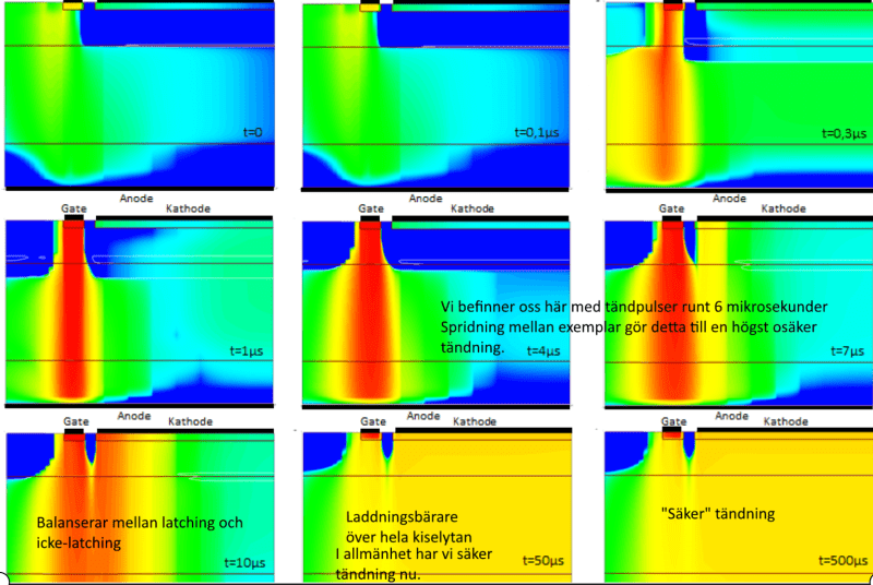

But this one has around 6 microseconds and that is a far cry from what I think is acceptable:
It results in triggering happening randomly. In picture below, the first doesn't trigger at all and the two following half-waves start to conduct but the latching current isn't reached. With OK gating, the voltage across the thyristors goes to zero when the thyristors conduct.

I then looked into the specs of the thyristor. It says nothing about very short gating pulses. But this says that it should be a lot more than six microseconds for reliable triggering AND latching:

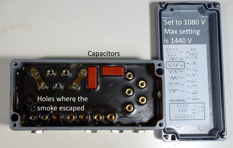

No, no diagram. The thing is potted and in a metal box.
The only diagrams are the connection diagrams. The box looks like this:
The trigger voltage is set to 1080 V. On another box, slightly different, it was set to 950 V. The user says that it shall be that high so load transients don't start something funny. Like shorting the exciter when in operation. Can't say if that is the truth or not. But it works (worked) well for years with that setting.

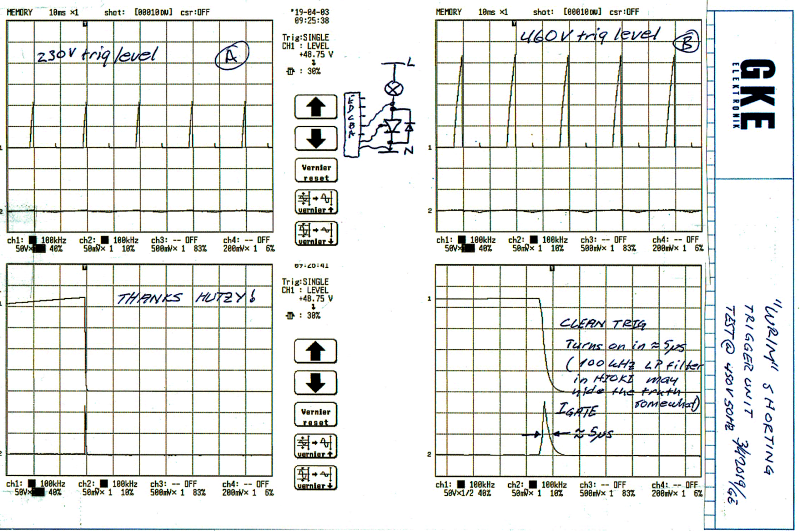

Yes, I got it. I'll make a copy of the result and show it here. The triggering is still somewhat "noisy" will add a small filter before the OVP. Thanks.

OK, Hutzy. It works very well:
I may have got something wrong. But it works beautifully. Stable, repeatable and low dissipation. And, what I think is important, I have accepted the short gating pulses. Good to have EngTips.
Gunnar Englund
The waveforms look good, so you did it a little differently but certainly not wrongly.
It's really quite simple once you get there, isn't it? Glad I could provide the nudge you needed.
