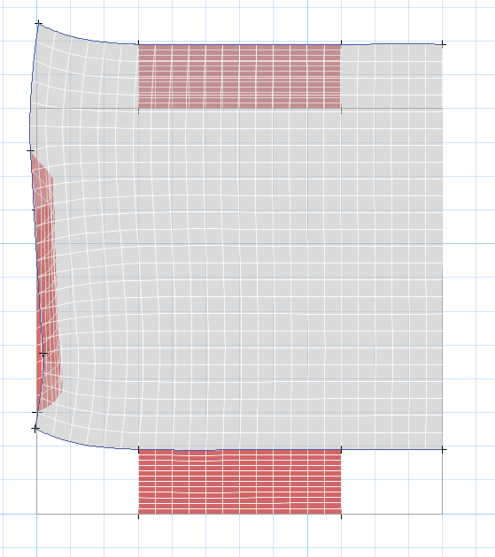

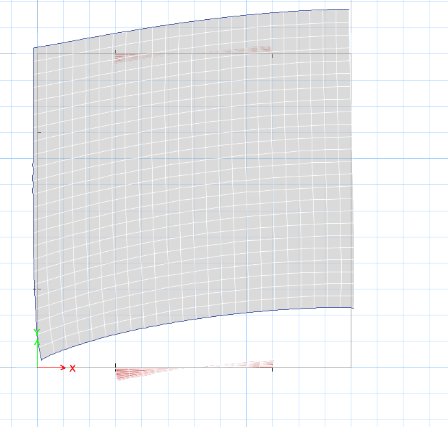

So, I was trying to build a simple model of a three sided box in Etabs (with a membrane element, no rigid diaphragm assumption) and was expecting get a deformed shape like the following, (expected mostly shear deformation of the membrane element):

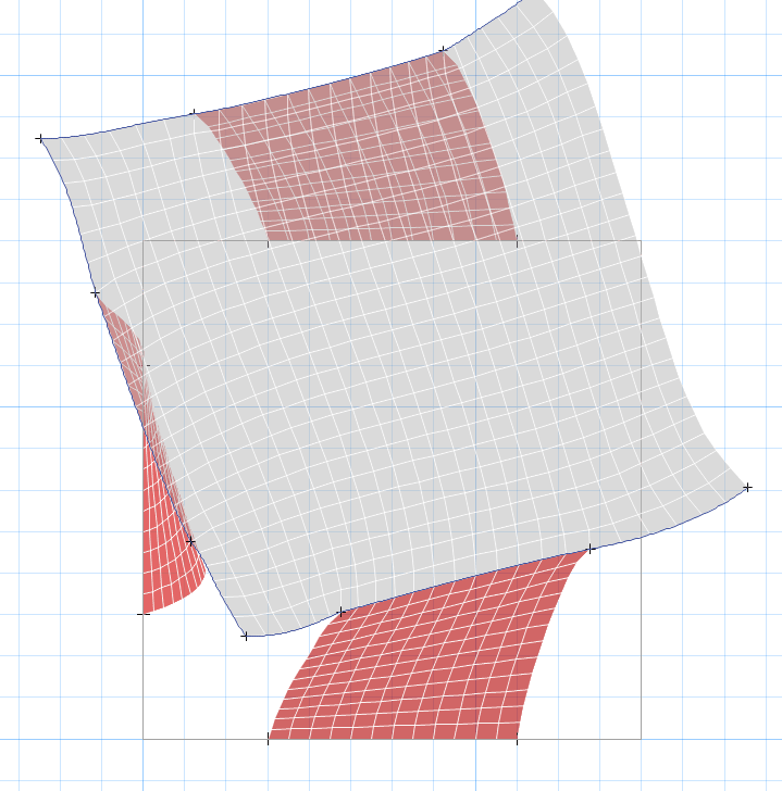

When I run my analysis, I get the following deformed shape:

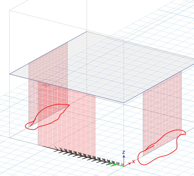

Applied loading looks like the following:
A few notes:
- I am unsure why the free (right) edge of the diaphragm does not deflect in a smily face upward manner​
- Floor is modeled as a membrane element​
- Chords and Collectors are modeled as steel beams​
- Self weight is turned off, only load applied is the lateral load shown above​

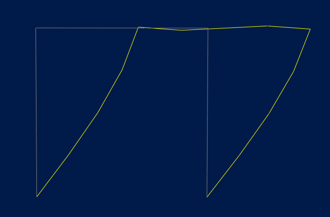

The other interesting thing is that the axial load in the chords and collectors exactly matches what I would expect (red = compression, yellow = tension):

- Do you agree with my anticipated deformed shape?​
- Any ideas on why Etabs shows the deformed shape that it does? Maybe something in our hand methods for diaphragms that does not match what Etabs is doing?​
Seems like the shear stresses in my diaphragm build up as you move page left (like you would typically calculate)

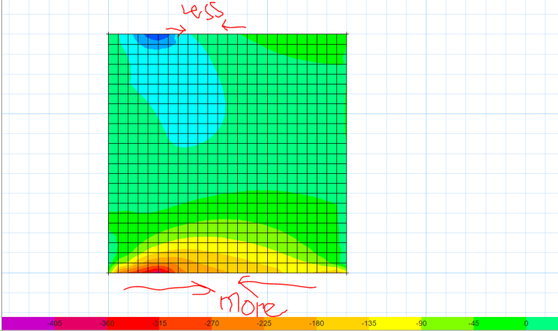

Only thing that maybe wrong with traditional assumptions is there seems to be some non-neglible axial stresses in my membrane element (see image showing compressive stress build up on front edge of diaphragm).
I've played with bringing down the axial stiffness but it makes my deformed shape look very odd.
Thoughts appreciated!
S&T

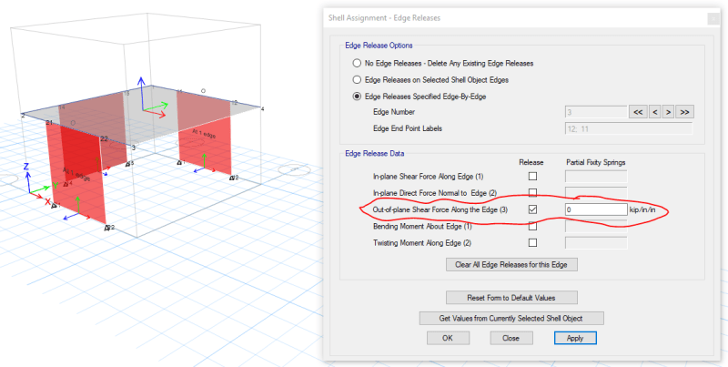

So, my mind went to the weak axis stiffness idea as well and tried the following ...
Releasing the shear in the out of plane direction at the top yields much the same deformed shape:
You can also see no reactions in the out of plane direction at the base of the wall:
I am having a hard time understanding why semi rigid action would create "reverse" curvature in my chords though. Mind explaining?
S&T

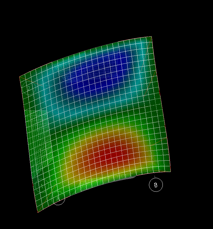

Just thinking out loud... deformed shape sort of looks like a pinned base moment frame if you turned it 90 degrees:
Still not sure if my intuition is correct on the deformed shape.
S&T

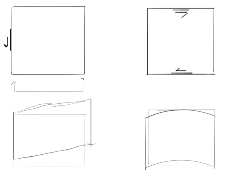

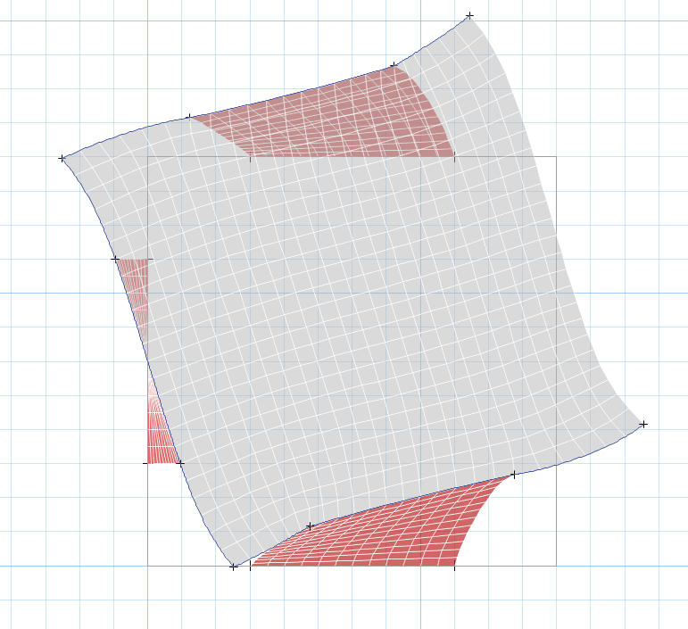

Your assumed deformed shape assumes a perfectly flexible diaphragm (or pretty close to one). But, that's not possible for this case. The shear gets resolved back to the one main wall, but what about the moment caused by that shear. That becomes a shear in the other two walls.... Which is only possible if you get semi-rigid / semi-flexible diaphragm behavior.
Try using super position. Apply a shear load at the main shear wall, see what it's deflected shape looks like (probably closer to what you originally assumed). Then apply equal and opposite shears to the other walls and see what that deflection looks like. Add the two loads together and then see what this combined deflection is. It should be pretty close to your original eccentric shear load.

I explored your super position idea:
Shear Load:
Shear Deflection:
Torsional Load:
Torsional Deflection:
Combined Deflection (shear and torsional case):
Again for reference (the original deflected shape with eccentrically applied load).
The combined superposition method you mentioned produces results more in line with what I would have anticipated (see smile face up at free edge).
The eccentric load method I orginally presented also results in more deflection which I would expect (both images have the same scale factor for deflected shape).

Celt, that graph is for vertical deflection, you can see the deflected shape of the diaphragm almost looks like a moment frame beam. Note that I have turned off out of plane stiffness in both models so I assume the deflection I am seeing is just compatibility deflection.
You bring up a good idea though, maybe axial stresses in the membrane element?
The image below is the axial stress from the etabs model (I do not think this is available to me in RAM SS).
This would explain the deformed shape I guess... not sure if it is reality though?
S&T

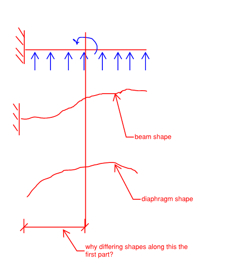

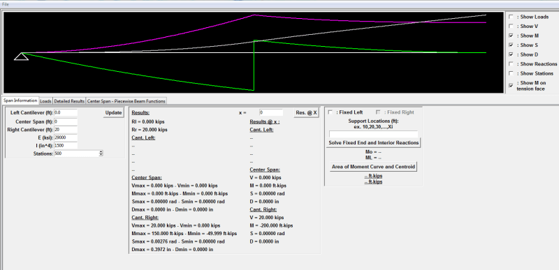

Trying to show it another way as a simple cantilevered beam,will be slightly off since the left can't deflect.
So I have added a moment at about mid cantilever to produce a 0 moment reaction at the fixed end, so left support only has a vertical reaction and the moment represents the couple formed by the walls.
Green line is the moment diagram
Purple line is the cross section slope, in the larger model that point moment becomes spread out so the peak would be more gradual
Grey line is the centerline deflection
Same thing with a series of point moments to smooth out the slope:
Open Source Structural Applications:
That's a good analogy celt83, the part that throws me off though is that my model starts in the opposite direction of your assumed beam shape:
Makes perfect sense that the end would curve back now.

so in my model it's a fixed-free simplification with a forced 0 end moment. This simplification also ends up creating boundary conditions of 0 slope and 0 deflection at the support. In reality your wall only provides a vertical support but both slope and deflection can and likely will be non-zero which would get you to the actual diaphragm deflected shape.
