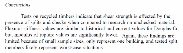

Here is a USDA Forest Products Lab paper on the aging effect that JAE discusses:
"Evaluation of Recycled Timber Members"
Results happen to relate to Douglas Fir which is likely relevant to the project.
