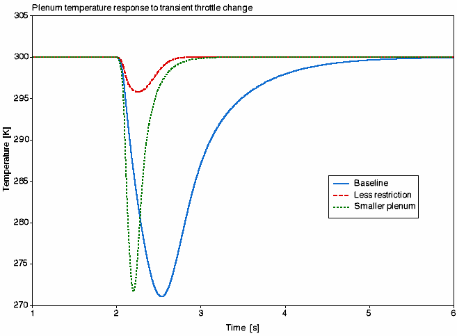

My engine simulations (different flow solvers, same geometry) are both showing a transient dip in the manifold air temperature after a sudden reduction in throttle angle. No fuel involved, just gas dynamics. My engine runs at a fixed speed (1000 rev/min) on near full throttle. I then snap the throttle to nearly closed, with no other changes. My manifold temperature drops by ~50K and then returns smoothly to ambient (in about 1 or 2 seconds). The pressure drops instantly and stays low. Is this something that's known about? It seems like it should be one of those undergraduate thermo problems:
- Constant downstream (volume) velocity outflow from a plenum
- Transient throttling upstream
- Plenum temperature does???
My two flow solvers are about as different as they could be, so I don't suspect an error in the equations being solved.

I am trying to understand some simulation, not measured responses. There is no fuelling and the speed is held constant (I can easily do this in a simulation, of course). The throttle is just an idealised area restriction, which changes instantaneously. I even removed all heat transfer.
Steve
Can you show a plot of temperature and pressure vs time? The temperature change in your simulation must be due only change in pressure in your case. The instant drop would be due to adiabatic expansion where work is extracted from the gas during expansion. There should be a pressure recovery as the engine slows. The expansion of gas through the throttle plate does not extract work from the gas and results in less temperature drop. This is what I vaguely remember about reversible versus irreversible gas expansion.
I'll see if I can produce some useful plots tomorrow. My engine speed doesn't drop - it's an imposed boundary condition, not a solution variable. In fact I can get the same behaviour with a constant volumetric exit velocity to represent the engine (removes pulsation effects). My aim is to isolate the plenum's behaviour to understand it.

Here's my understanding now:
We are just seeing basic emptying & filling behaviour here. Transient behaviour of a plenum, not the effect of pressure waves. The engine is pulling mass out of the plenum at a given volumetric rate and the throttled intake is supplying it. When the throttle area suddenly decreases, the engine still pulls mass from the plenum, rapidly cooling it. The throttle's rate of supply of more warm air is limited by the pressure gradient across the new area. As the gradient is establishing itself, the temperature rises back to steady-state value, that of the ambient.
The dip is basically the result of two competing boundary conditions. The shape of it (depth, duration) is controlled by the volume of the plenum, the speed of the engine and the restriction of the throttle.
Steve

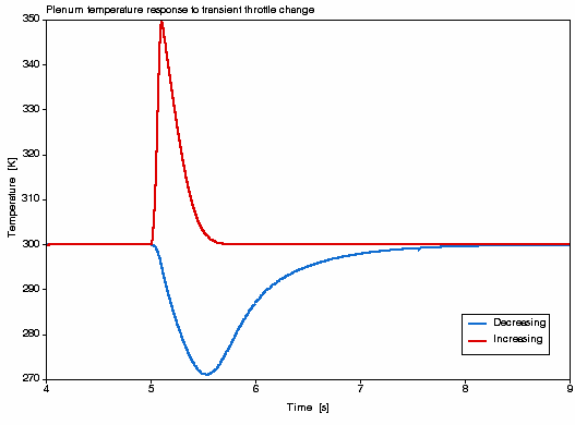

What happens with a sudden increase in throttle area? (in your simulation)
There is something wrong with your simulation. Pressure drop across the throttle is the sole source of any temperature drop. You should be getting a similar pressure drop under the final steady state conditions and consequently a similar temperature drop as air expands across the throttle.
What is happening to plenum pressure during the time period shown in your chart?
je suis charlie
I get the opposite effect hemi. Different shape (magnitude & time constants), but in general: it goes up; it goes down again. I'm just swapping the before & after diameters here, so the plenum conditions (pressures) just before the throttle transient aren't the same.
