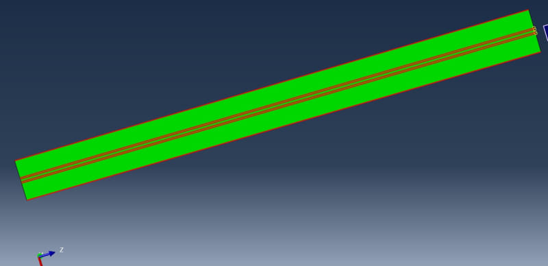

Hello there,
I'm learning Abaqus scripting with the Abaqus scripting reference guide. Not a beginner in Abaqus, but the scripting part is pretty new to me.
To apply local seeds to a flange, I'd like to select edges along the Z-direction of my part. It does work with the findAt command. However, since the partitions might change during parameter studies, I'd prefer to find all the edges via a getByBounding command and to put them in a set. I tried GetByBoundingCylinder, Sphere, Box.... Whatever I do, the set "seedsedge" always stays empty, although the reference guide clearly states, that these commands may be used to select edges for an edge array. When I apply a boundingsphere or cylinder in such a way, that it contains the whole part, I get all the edges inside. But thats not why I want. I just want the long edges in the set (see attached picture).
So, this might be an easy question for experienced scripters. However, I can't seem to find useful information on the web, so I hope for someone who could push me in the right direction.
Happy 3/14 everyone.
Here's the code:

edges = mdb.models['Model-1'].parts['Flange'].edges.getByBoundingCylinder((-b,0.0,l/2),(b,0.0,l/2),b)
mdb.models['Model-1'].parts['Flange'].Set(edges=edges, name='seedsedge')
