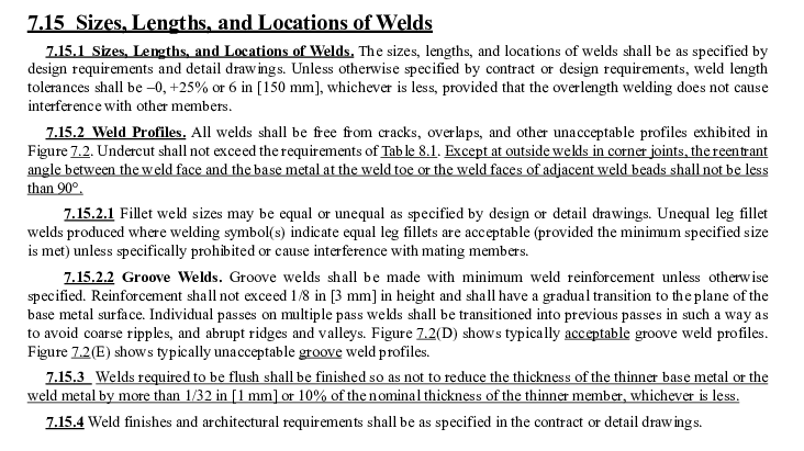

If I grind flat (remove reinforcement)the weld, would that still conform to code as the code doesn't mentioned the reinforcement can be removed.
Have a read of 7.15, and 7.15.3 in particular.
In your case, thinner member doesn't apply, so the weld cannot be reduced by more than 1mm when grinding flush.

Are you refering to D1.6? Section 7 is for stud weld. My copy of D1.6 is 2007 version.
Goodness....
The first rule of code compliance is ensuring the proper or latest version of said code. The latest version of D1.6 is the 2017 edition. Stud welding is now Section 9. Here is the snippet I was referring to:
