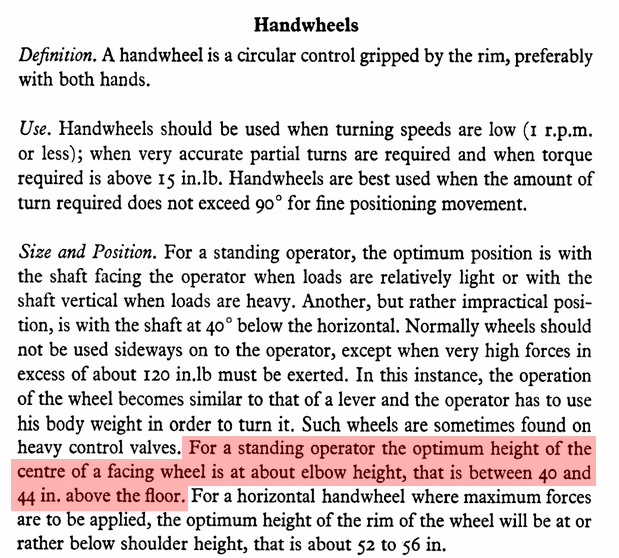

I am a Structural Designer wanting to know what the guidelines for horizontal hand-wheels and their height above grade. If anyone knows where it might be addressed in OSHA, please let me know. These are hand-wheels that are not typically used very often, but only when isolating a line. Currently to the center-line height it is about 71".

From "Ergonomics: Man in His Working Environment":
[idea]
Our treatment plant has 42-inch high guardrails near numerous handwheel operators, which creates "knuckle busters" conditions.
You should check heights and layouts to avoid conflicts at your installation.
See uploaded file which IMHO gives a reasonable approach to acceptable handwheel heights but actual may vary between clients and their operation preferences. Note that 71 inch seems to me to be on the high side except for small bore valves, think of the torque required.
I would also add that it would probably be acceptable to clients operators to add a permanent or portable platform/steps on ad-hoc basis where this type of height is unavoidable but try to design out.

Yes, "optimum" handwheel height is important: Apply those guidelines above whenever you can.
But.
To get the best handwheel height - for a valve used infrequently (for isolation only), change the grating elevation of the platform. Do not change pipeline elevation to move the handwheel unless there is 0.0 cost impact! (No effect on vent lines, tanks, pressure vessels, structural supports, other pipes in the pick rack, drain lines, drain slopes, etc, etc, etc.)
Add a handrail and grating? Much less expensive than rebuilding a pipeline.
Use a chain-handle extension operator? Done very often for handwheel/manual valves 6-10-20-30 feet above floot level. I do not see chain-operated for 1-2 foot offsets though.
