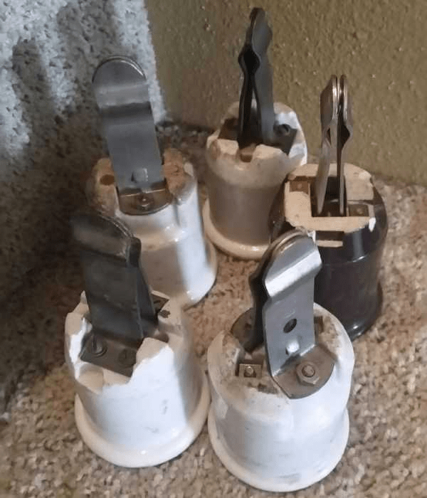

In the photograph you may see a small button between the ends of the bayonets.
This would short out at around 100 Volts and bypass a burnt out lamp.
The mogul lamp socket was special in that the center contact was spring loaded and had an extension tab.
When a lamp was removed the spring would force the center contact upwards until the tab made contact with the shell, shorting out the lamp holder.
Regulators were protected by a similar device but with a permanent shorting link. The button was about 3/4 inch in diameter and resembled the tire only from a toy car.
A small circular lead plug was pressed into one side of the center hole.
A number of mica washers were then inserted, the number dependent on the loaded circuit voltage.
In the event of an open circuit the current would flash over between the lead plugs or disks.
The arc would melt the lead that would flow together and short out the regulator.
