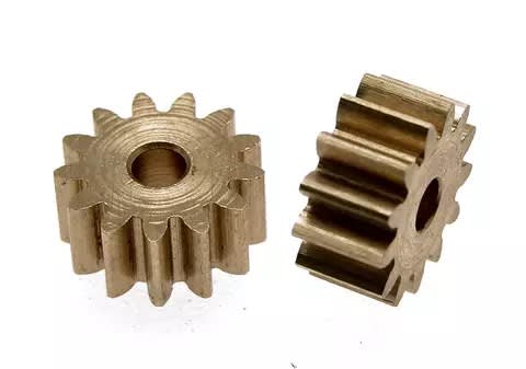

Type: Spur Gear Press-on with two beveled faces for easy pressing, hubless
Material: pure Titanium grade 5 6AL4V (suggestions??)
Coating: ??? Suggestions??
Modulus: 0.5mm Module Metric Spec
Teeth: 13
Outside diameter: 7.75mm
Width: 3.2mm
Hole: 2mm
Pitch: M50
Pressure Angle: 20

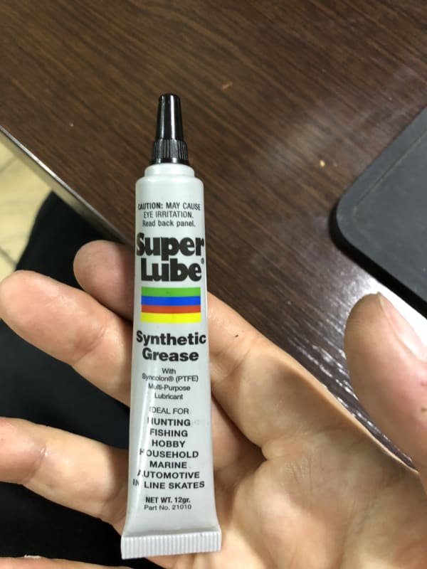

This is a type of grease used to lubricate the small (pinion) and big (nylon) spur gears.

Less than half the pinion width is engaged with the spur gear in the picture you provided. I'd say that pinion could be lightened considerably by thinning, but leaving the "hub" full width to maintain the interference fit with the motor shaft.

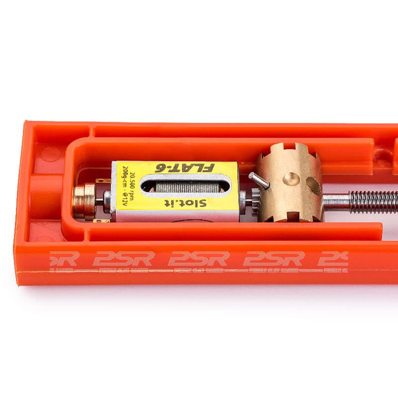

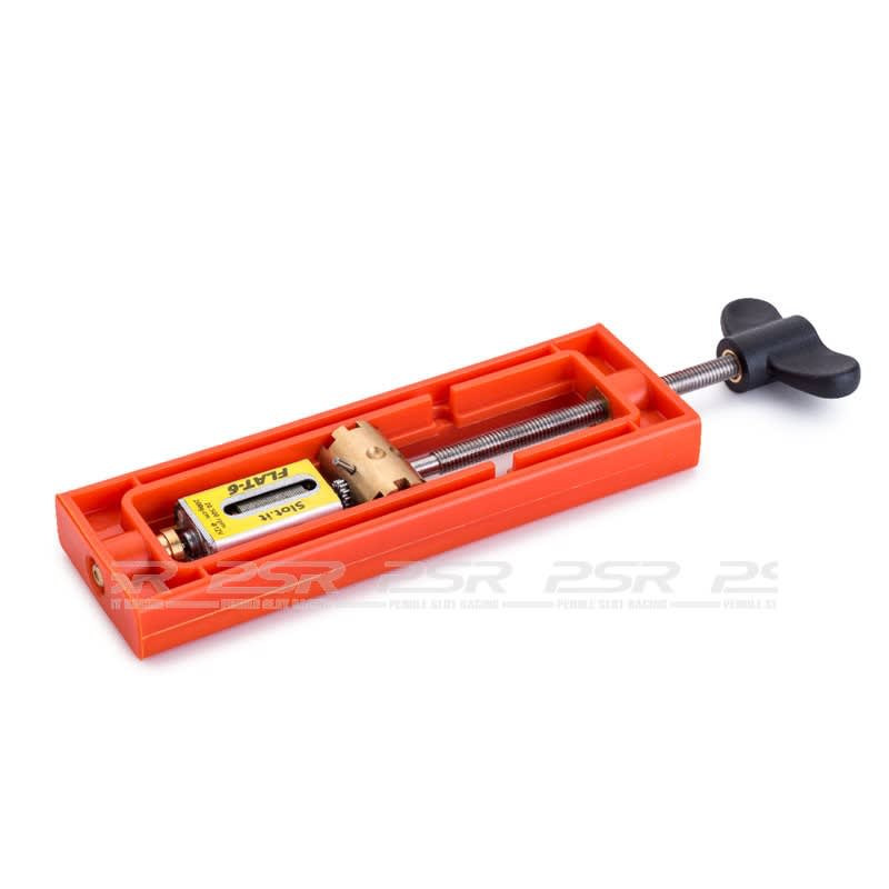

Thanks for the inputs. Yes, I’m still working in the final drawings. About pinion installation, it is always pressed with tools like that below.
