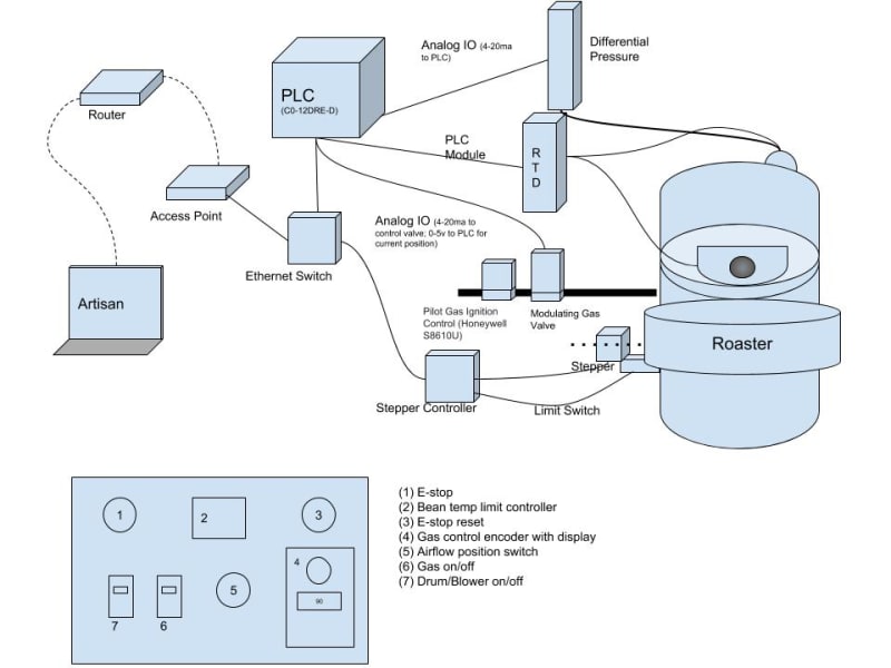

I've acquired an older coffee roaster that I'd like to update with some automation equipment (PLC, RTDs, modulating gas valve, etc.). I believe I can bring it all together and make it work, but I am not sure how to build the panel suitable for a commercial environment. Do I need to reach out to a panel shop? Also, am I overlooking any potential issues (regulatory) with adding a modulating gas valve?

That's not a 'light' task. It can absolutely be done but you can get into some nasty spots doing it. I'd have to ask what your experience with doing systems of that complexity?
There are standards or at least standard ways of running stuff like gas valves and burners. As you can imagine a lot of safety additions are needed. As for a panel shop that isn't a topic that you walk into a panel shop and declare you need 'a coffee roaster controller' in a couple of weeks. Most shops would not be capable of pulling it off.
Does it need to be a listed panel? While often that might be needed in a big city it might not be needed in a lot of places. If it needs to be listed because the insurance company said it does then you are doomed to needing the services of a panel shop.

Was the roasting not adequate with the original temperature control, presumably cycling on-off or low fire to high fire?
The firing rate temperature controller output would have to be changed to accommodate a modulating valve and the flame safety logic would have to account for purge with a modulating valve, probably a different flame safety control.
Keith's comments about a panel meeting standards like UL are to the point.
Is all this upgrade investment going to be profitable for a one-off?

After some online searching it looks like NRTL listing is required here in California, but I'll check with the city on Monday.
I reached out to a panel shop and he also mentioned this would be a challenging project and that the cost would probably be higher than I would expect.
I can't say if the investment will be worth it or not. I am enjoying the process, yet I will need to move toward commercial viability. The newer roasters have modulating gas values, data logging and control features. I guess if this turns into something too challenging/expensive, I can sell it and buy a newer one. Although, there is something special about these older rosters.
A panel was added to the roaster probably 10-15 years ago with a temperature controller to cut gas at a set point.
Temperature is controlled manually by turning vales on two rows of burners under the drum. Controlling bean temperature over the duration of the roast is less than exact. My objective is be able to have the bean temperature follow a predetermined roast curve and to do it in such a way to smooth the rate of rise.
The plan is to use an application called Artisan Scope to not only show roasting data while roasting but to also control the roaster (via Modbus). The application also has a built in PID controller. This is what I was thinking:

If you can use electricity this entire thing becomes almost trivial. Yes, the energy is more but the control is probably more than twice, heck, probably 5x more accurate than gas and you gain complete control of the air flow since it has nothing added in it like burnt hydrocarbons and a forced amount of air required to make combustion ratios happy. You can modulate electric heat to precise levels. No single mistake can level the place. And, as for 'modern and commercial' you can add solar to completely wipe the energy consumption and use that as a marketing tool that you can never use with gas. You can probably do your own control panel or a panel shop could probably handle that if you want to play that game.

Interesting. Just adding some NiCr coils where the burners would be? I'm not sure if that'll provide enough heat. Although, you're right, I could slow down the blower. I like where you're going with the marketing too =).

Yes, anywhere in California you are going to need an NRTL label for it to be installed where a permit is going to be pulled. If the gas valves are not INSIDE of the panel, they don't count, but the valves themselves may need to be listed.
