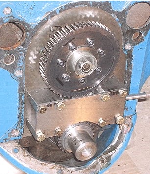

As I mentioned in my picture above, that particular case is notorious for breaking the springs and the pieces of spring damage the gears.
I asked about hydraulic gear pair loading because it could be done very compactly in my application, and space is very limited. I would substitute a gear pair for the idler gear of my cam drive which is only 1.970" OD, with no available space around it. Engine oil pressure would be routed through machined passages to cavities in the mating faces of the gear pair. This would avoid any enlargement of my gear system. (Cavities would be offset radially, so that oil pressure would attempt to offset them more).

Rather than put up with the gear whine, I put a normal timing drive in the engine and it's serving me well. But I'd really like to someday use the variable-cam-phasing on the street. While testing it did an impressive job of "taming" a very lumpy cam, by advancing the cam as little as 9 degrees (crank) at low engine speeds.
It's no wonder you were "having a hard time picturing" since I misspoke. One gear would have a slot for pressurized oil and the other would have a dowel pin "piston" protruding into the slot. Dimensions are very cramped but there's room to allow 60 psi oil pressure to develop about 4 pounds of force. Any idea what magnitude of spring force would be typical for such a gear pair? Idler gear pair is 1.8275" pitch diameter, 22 tooth (between 27 & 54 tooth crank & cam gears) with "piston" at 1.110" pitch diameter. Each gear of pair is .312" thick.

I'm not getting needed answers nor have I found a gear company offering the LNS grinding, so I'll simply duplicate the gearset with helical gears- and somehow deal with end-thrust of the idler gear.
