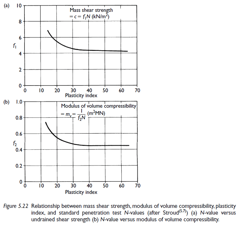

If you have any further information about the "clay" like Plasticity Index and SPT-N values you can use Modulus of Volum Compressibility with:
consolidation s = coefficient of compressibility x average stress increase through layer x layer thickness
as maxim22 suggests.
(Note: Don't forget to calculate the effective depth of your load before you use Layer Thickness)
