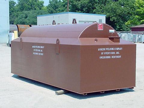

Hello all,
This is my first time posting. I have been to the forums many times over the years, but never have I been this stumped. Hopefully someone has some experience with this design.
We are evaluating an existing tank for a client located in the bay area of California. The tank is a 2,500 gallon above ground tank containing vehicle fuel. It's horizontally oriented, cylindrical tank and is constructed within a secondary containment/double wall enclosure. The tank base is a completely flat bottom. We have been tasked with evaluating the anchors and restraints for overturning and shear. We analyzed it at a rigid, non-building structure. The regulator has denied our calculations as deficient and states that we need to use ASCE 7, Chapter 15.7 for the basis of our analysis. I disagree with their code reference, as 15.7 is for design/analysis of tanks and vessels supported at the base, like a water storage reservoir or grain silo. They also want an analysis of the available freeboard and resultant force of the sloshing of the tank contents. The freeboard equations provided in Ch. 15.7 assume a vertically oriented structure with constant cross-sectional area with regards to the height of the contents. A horizontal cylinder has a varying cross-sectional area.
Here's my question: Is there a better reference or design guidance for horizontally oriented tanks? Am I off base here, or is the regulator incorrectly siting code?
Any help would be greatly appreciated.

I’m not an experienced tank designer by any stretch, and many of you know the code specifics much better than I do. But, it seems to me that you might have a problem which needs to be addressed in several separate steps. Your picture and some of the others suggest that the primary tank is a horiz. cylinder on a couple saddles, and would be analyzed as such. And, I agree with JStephen that sloshing should be much less an issue in the horiz. tank than in a large vert., flat bottomed storage tank, which would be much more susceptible to their detrimental and unbalanced actions. Thus, it has typically been (probably been) ignored in normal horiz. cylindrical tanks. You need the exact design and construction details of this system so you know how to treat the two saddles as they attach to the foundation in your analysis, maybe through the bottom structure of the outer rectangular containment container/tank. Then, the second problem pertains to the outer rectangular containment tank, which might be partially filled if there is a failure in the primary cylindrical tank. In this configuration sloshing could/would be an issue. If you look through EQ design and analysis textbooks, ASCE Jounals and papers written by Prof. Anil K. Chopra from Berkley you might find something to hang your hat on. He and some others out at Berkley did a bunch of work on liquid sloshing due to EQs.
Is your tank like the one in this photo?
I would think it would qualify for rigid mass analysis per 15.7.6.1(a). Unless it is Risk Category IV, which would trigger the sloshing calc per 15.7.6.1(b). This rigid mass approach (V = 0.3SDSWIE from Section 15.4.2) is what I usually use with horizontal flat bottom tanks like this. This part of the code has always given me some consternation because it directs you to use rigid mass analysis in part (a), then goes on to say hydrodynamic analysis is required within the same clause as if part (a) wasn't there.
I sort of agree that 15.7.14 is also applicable to your tank, which directs you to assume that the tank and contents are a rigid mass when designing anchorage and foundations. It's fuzzy how to meet that requirement, but I would argue that the above equation from 15.4.2 meets the code intent in 15.7.14.
Putting confusing code requirements aside, IMHO it just doesn't make much sense to consider sloshing on a tank like this for the reasons stated in the OP. But you can try to point to 15.7.6.1(a) or 15.7.14 to back up your stance with the regulator. Good luck
