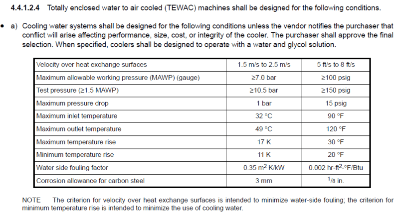

I am reviewing a quotation from a vendor that wishes to deviate from API 541's TEWAC performance requirements. (API 541 section 4.4.1.2.4)
API 541 requires TEWAC's to have the following performance thresholds:
Maximum temperature rise 17k
Minimum temperature rise 11k​
The vendor is wanting the following thresholds:
Maximum temperature rise 5k
Minimum temperature rise 3k​
Is there a huge issue with this? The cooling water will be water only.
Great question... I've included a snippet of API 541's section in reference:
Ok, it's water inlet vs outlet temperatures. The vendor insisting on lesser water temp rise is good, no?
Normally, 3 to 5 deg C rise in water is what we see in such water to air cooled motors and generators. No idea why API would want a less efficient heat exchanger.
Muthu
edison,
The footnote at the bottom explains it - API may be trying to acknowledge that cooling water is at a premium in many process plants. Not all plants have cooling towers, some rely on power-hungry fin-fan heat exchangers for cooling.
