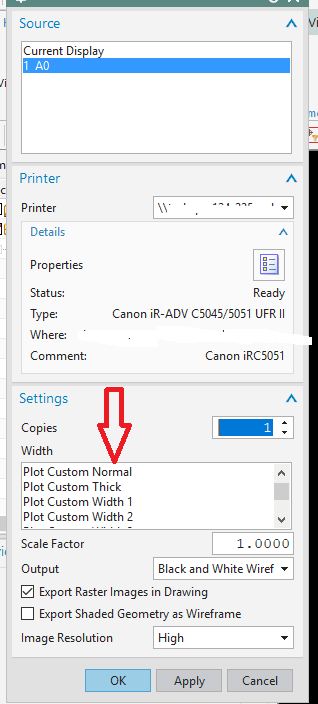

Is there a way to find what the "pen" settings are for the various choices
that I have for the line widths when printing ?
Jerry J.
UGV5-NX11
I believe the widths can be found in your customer defaults (Gateway -> plotting -> widths) or possibly gateway -> printing.
