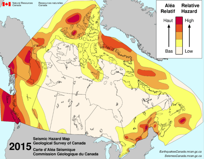

Thank you for that information, it has been very helpful. Can I ask whether seismic design is common in Canada? Perhaps the West Coast of Canada?
I am planning on moving to Toronto though. Yes I am somewhat concerned about the lack of opportunity, but I will try my best, if I am unable to land a job in design, I will try working on the construction side. I do not think there is a country in the world where it is hard to get a site engineer job to work for contractors.

Seismic is a big deal on the west coast of Canada and, also, not insignificant in some eastern regions.
