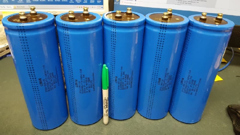

Look at what just landed on my desk.
I want to take care of my Precious.

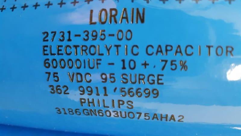

New. Used for a week 18 years ago. Never powered on since. Kept in temp stable 68F since then.
What should I limit the leakage current to as I reform these babies?
I suppose I'll take a whole day to ramp them.
I feel a 18650 spot welder coming on..

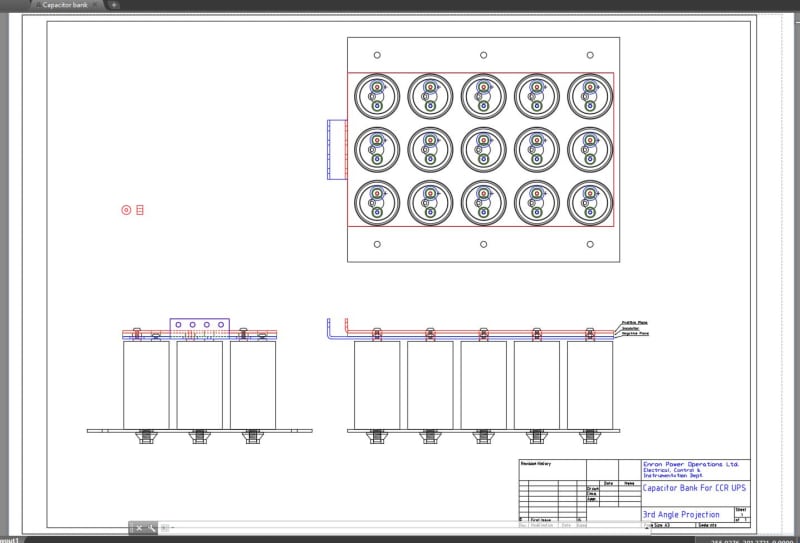

We had this little bank built to replace a woefully under-sized DC link reservoir installed in our UPS which periodically used to brew up. The OEM didn't want to know so we took matters into our own hands: our in-house solution was 15x 4700uF/400V in parallel - the ripple current handling was 'sufficient'. :-)

Since they're "only" 60mF (in the era of Farad supercaps), even a smallish current would charge them rapidly.
So perhaps a voltage (current limited) manually stepping up over hours would be best. As opposed to "current".
I put one on a lab supply. I hooked a voltmeter across the cap and ran the supply current thru a 6-decimal place HP bench ammeter.
With the current limit all the way down I set the disconnected supply to 20V. I then turned up the current limit to 10mA. It took about 3 minutes for the cap to reach that. Once it did I left it for 5 minutes and came back to see about 1.5mA still going in. I bumped up the 20V to about 22V and after about 3sec brought it back down to 20V. The current went briefly backwards draining into the bench supply then went forwards again and ran back up to about 1mA. Clearly there was about 1mA of leakage at 20V. After an hour I disconnected the supply, turned it up to 40V, reconnected and watched, all with big safety glasses on. That took about 4 minutes to raise the voltage. E = ∝V2? After an hour it was leaking about 800uA.
I get the feeling if these had all been hit with 75V pushed by 480V 100A service it might have turned out not too well.
I expect the leakage to diminish but haven't had the time to form it long enough.
