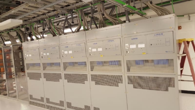

I have just the chargers for them too! Here's a shot of five of the nine 1,200amp chargers.
Keith Cress
kcress -
Yeah, big batteries are scary - they can throw an awful lot of energy into a fault with nothing able to interrupt the current.
Keith - that's a lot of rectifier capacity!

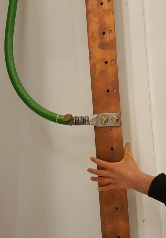

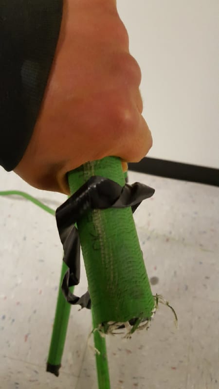

Place had six battery banks in a basketball size room. They were about 15feet by 8 feet banks. I noticed yesterday that they'd been cabled up to two busbars that are 4" x 1/2".
Random ground cable hanging from the ceiling:
Was going to connect to this bus bar before job went still-born.
Keith Cress
kcress -
