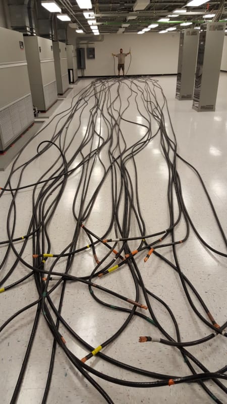

I spent today doing this.
GAG!!
Grueling..
6 hours to pull two thousand, two hundred feet of 750MCM in 30 pieces out of 6 conduits by hand - in the dark (no power could be in the building for the fun). I'm shellacked.

When you get that to the recyclers you'll get a nice boost to the coffee fund.
Bill
"Why not the best?"
Jimmy Carter
You can probably get more if you strip it first, usually about 50% more by weight, but you lose the weight of the insulation, so the net gain is usually about 20%. but 20% of $8k is $1600. Google plans for a home made wire insulation stripper, they are not that complex. $500 to make one, $1600 gain, it would be worth it in my opinion.
Hi Jeff. 250MCM to 750MCM is 90% weight pure copper which is much better than the usual wire.
Unskinned is selling for $1.5 to $1.6/lb and skinned is $1.9/lb. Still maybe worth skinning it especially since a bunch of free-range machinist's are involved.
