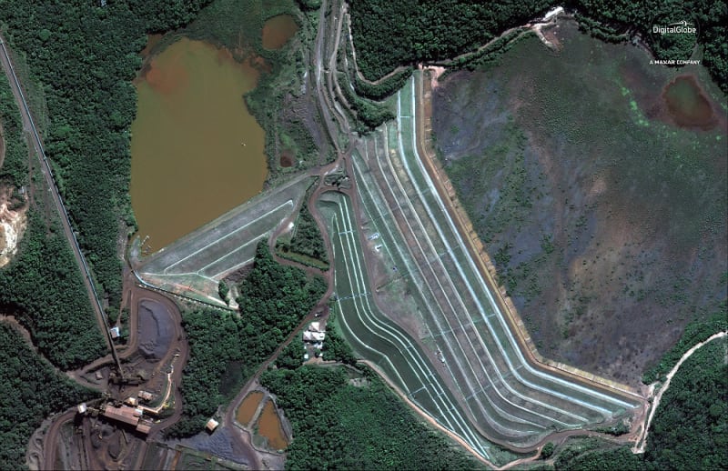

Best guess it was this dam that failed.
Google Maps Link
Perhaps an underwater landslide.
Photo: Link

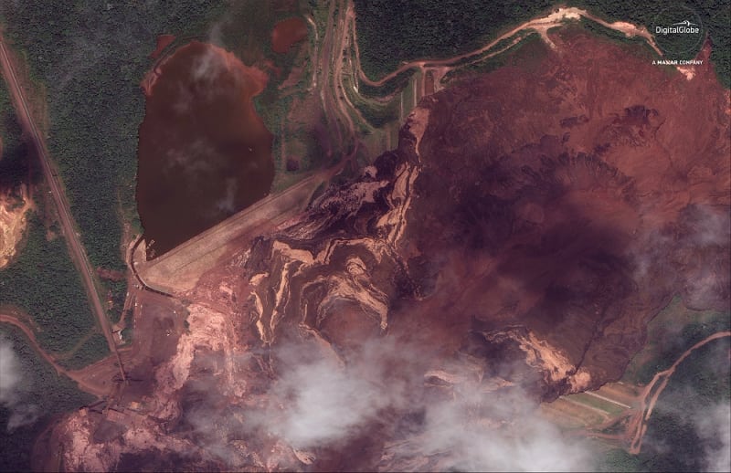

I had to go look that up but it seems to be based on using the deposited material in the dam as the basis of the foundation of the next stage. Now if all those sensors and readings and analysis was being done correctly, then this appears to be a sudden catastrophic failure probably starting from the bottom. From the photo above it looks to me like the initial section is the bottom 3-4 layers which have an enhanced V shape and then followed by straighter lines. As this website state, upstream design is the most common design to fail. I've not heard any mention of an alarm or warnings from the dam itself so this seems to be a very sudden collapse.

Looking at the first link photo, I think it was the dam on the right in Epoxybot's image. As others and the press have mentioned this is oddly similar to the Fundoa failure. Looking at the dam this one also has a flat bench offsetting the dam (similar to Fundao) and has two outward bends (looses 3d beam strength). I wonder if they will find similar causes as with the fundao dam failure. The starter dam being built in 1976 it is unlikely they started out with good beaching practices to prevent slimes near the starter dam. Given the overall height is 86 m the structural shell would need to be thicker than a compacted perimeter road.

Before and after shots
