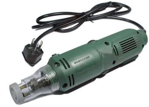

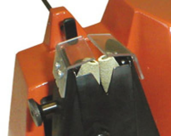

There are lots of tools specifically for that.

Then there's the cheapo standard found EVERYWHERE:
And if you're looking to do smaller wire:
Small Magnet wire stripper
Link

Strip to tin, correct.
24 AWG
We need to remove ~ 3/8” of coating off each end of a 2” long wire.
Q~
