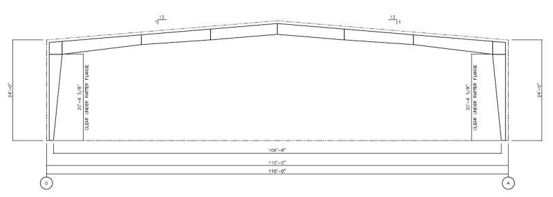

If they cannot get more accurate information from a supplier, consider this: I recently did the foundation for a 110'x25' clearspan in a 20 psf RLL, 5 psf Snow and light wind load. It was a 25' bay space. The loadings don't get much less than that. The clearance under the rafter was 20.5' near the edge of the building (more as you move from edge). The column was 12" at the base and about 36" at the top (knee). The columns set back 8" from the edge of the building. As a close approximation, on a clearspan with a tapered exterior column (not a straight column), the rafter depth at the knee is fairly close to the column depth at the knee. If your loadings are light like mine, these dimensions may give you some idea of what yours would be. Your vertical clear would be 21' to 21.5' etc.
I need to make one correction to previous post. The building I did was 24' tall, not 25'.
